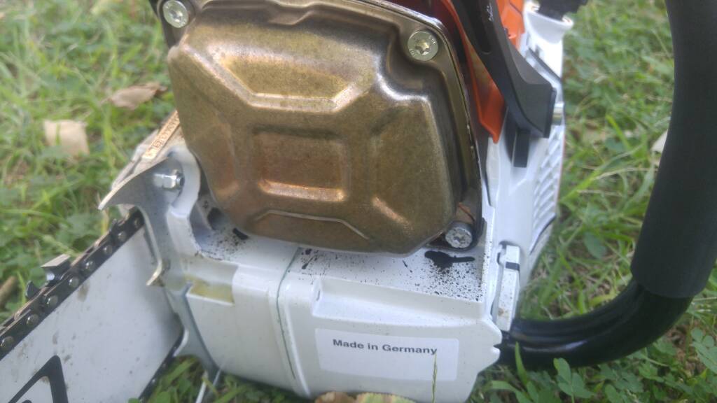

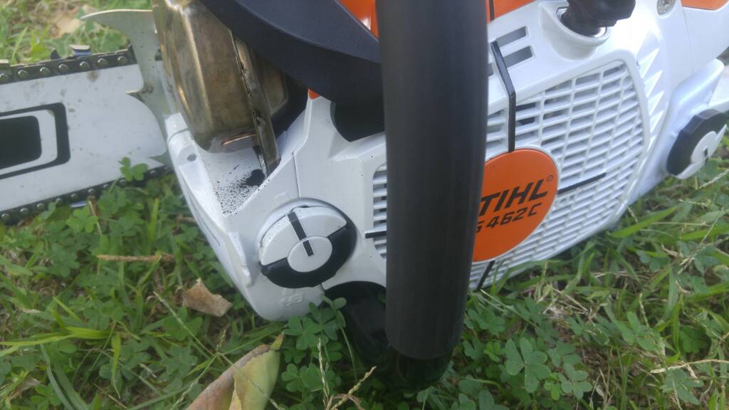

By the way gyus does anyone know what is this black thing coming out the muffler??? Always when i get a new saw or rebuild one (Piston- Cylinder), I add 40:1 oil mix for the break in. ...and always this thing happens on the first tank!!! I has not been a problem for me. I have a 5-6 years old MS261 which has a P/C like a new.

If it is a brand new saw on first tank it could be the assembly lube or break in lube added and getting blown out the exhaust.
That's what I think!!! It happens always on every first tank. I check my saws twice a year and never had an issue!
