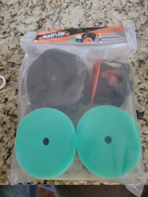

Just got back from little league opening ceremonies and look what was on the porch when I got home. We'll be loading right back up here in a little while for to nights game, so I wont get to install it til tomorrow. 20260328_150430.jpg

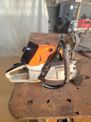

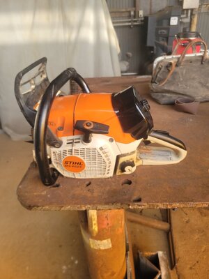

Just got mine together. Be a few days before I get to run it. My brother just cleared property for his soon to be established homestead. We saved out all the ash and a few oaks, so there will be some firewood cutting happening in the near future. I'm about to clear a fencerow also, so there is some work in it's near future.
@Loony661 , I did end up with a half moon hole when I trimmed the top cover, but the new filter top covers it completely. 20260401_083214.jpg20260401_083207.jpg

That does look superior to the WCS filter.
