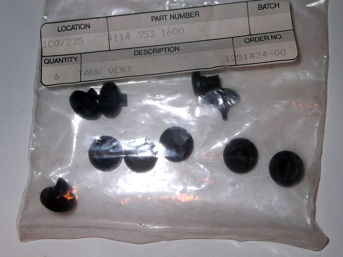

Speaking of duck bills Another of one of many "works in progress " is a 95 cc Sears gear drive with a Lauson carb I managed to blow the duck bill check valve into orbit .I need to find something to replace it .

I'm guessing that's probably a smaller duckbill valve Al - I know there's several sizes available for modern Homelite and Poulan saws -
maybe one of those would work?

You can get the OEM type duckbill valves from Elder Rubber in Irving, TX. You have to buy 20 pieces at a time (if I recall) but they end up pretty reasonable per piece. You can also get the OEM type from Bob Johnson for $6 each + shipping.
