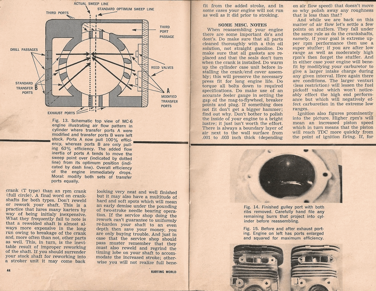

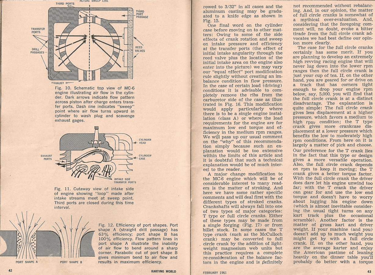

I posted these years ago - an article on porting McCulloch kart motors from 1961 by Jim Butler. Jim was a premier kart engine builder/two-stroke tuner and
wrote hundreds of articles on building and tuning two-stroke engines.

Cool stuff thank you for sharing the information Jacob.
I got a lot more to post, I just need to chew my way through the archives. I followed the instruction in the article when porting a 125 block years ago and it turned out well.
