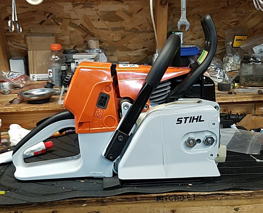

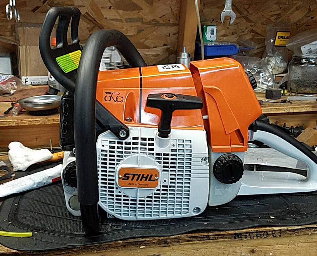

This is what your 064 you want it too look like
Rattler has it he just ported it
Dustin will bring it back early aug

Close but I want to reuse as many of the original parts as possible that still can be made to look 90% so I'll keep the old style caps, top cover, carb housing and opaque tank as well as the old made in Germany and 064AV electronic quick stop badging. Trying to make it as close to 1986 as possible.
