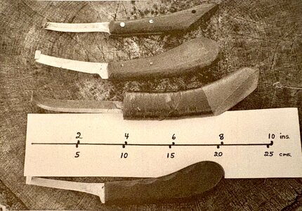

UPDATE:
These are a couple of hoof knives that I picked up from that mail order place named after a large river in South America.
I brought them to a paddle making class at a wood shop just to play with them.
The photo shows a young woman grasping one with a non-standard grip.
Definitely carved easier in soft wood. I have to learn how to sharpen these curved edges.
