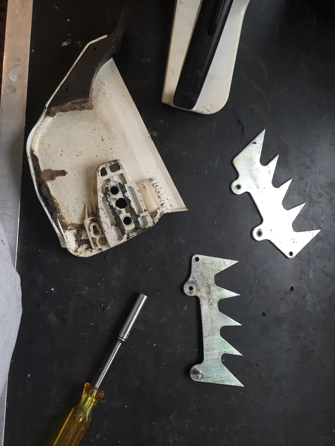

Took me a while to remember where I put the dogs.
Strapped on a 28 inch bar
