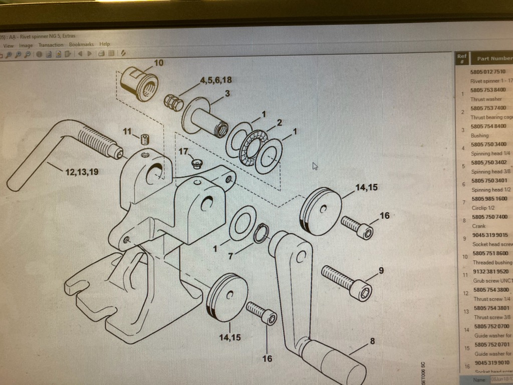

so my "kit" arrived over the weekend...chased a few threads and looks good 2 go. waiting for some chain to arrive. does anyone have an operator manual for this setup.
@PA Dan
lots of parts to "match"
so far very happy...the ebay seller is send a bulk box of straps and links..
just because im a good guy. :)

All I got is from Stihls website. Let me know what else you need ill see what I can get.

Where's Dave F when we need him? Translation please...
DND 9000
4:13 PM
800
Feb 6, 2016
758
1,674
Germany
Position 4 is 5805 750 3400 Spinning head 1/4", 0.325", Picco
Position 5 is 5805 750 3402 Spinning head 3/8", 0.404"
Position 6 is 5805 750 3401 Spinning head 1/2", 15 mm
Position 18 is Spinning head 1/4" Picco (only availible with 5805 007 1000 Tool kit 1/4" Picco which contains 5805 752 0701 Guide washer for 1/4" Picco-1/2"-pitch, Spinning head 1/4" Picco, Thrust screw 1/4" Picco)
