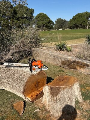

Does 404 help with chip flow problems like the chain being locked solid in the bar as if by chaps? Siberian elm, which is no elm, but like cottonwood.

404 has better ship flow. But idk if that helps with ur problem. Can u try a skip chain?
I’m running skip square. 30” cannon bar was ok. 32” stihl was really bad. I need to inspect the bars. The only thing I can think of is worn out rails. Gonna check chain brand too.

461 cranked up, coming off the tip. 30” was ok previous day.
Some trees were quite wet.
I checked my cottonwood vid with 288 and I think I was running “long” 36” old worn cannon 119 driver and it did choke once, nowhere near as bad as this old stihl bar. Husky square skip on the cannon.

I checked that stihl bar and it failed the straight edge test.
In which way? Across the top of the rails, or bar plate tweaked? My Dad had a Hardnose Stihl and wore and ground them so far he had to grind the bottom of the drive links ..so the tie straps would set on the rails. He used a table saw with a stone in it to true the rails.

I put a straight edge against the side of the bar and a cutter, the cutter tipped sideways enough that it did not hold the straight edge away from the bar. Groove too sloppy.
I think in order to properly repair the groove, it needs to be pinched closed pretty tight and re-ground out.
Anyone have experience with this, like on a bar shop?
I actually have a mess of old worn bars…
