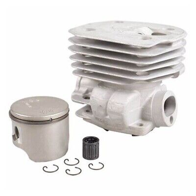

I tried ordering from Firedog & they just refunded my order on the 346xp cylinder.
Cylinder: I went ahead and ordered from the cheapest place Google could find me that looked reputable. Used PayPal because they’re quick to refund you if you’re ripped off.
I’ll let you know if it actually ships or not!
A Hyway top end with pop up is $120, so I consider an extra $30-40 to be money very well spent.
I’ll be curious to see what kind of squish clearance I get with the 346 upper. Wether I need to do work to the cylinder base and the squish band to get the most out of this saw. If so I’ll probably resort to sanding the band and cylinder base carefully like I usually do. I’m not blessed with a lathe.

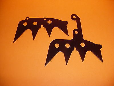

Bucking Spikes / Dogs: I don’t like any of the curent options. They’re either stubby factory ones… or these giant bastards that cost you 2” of bar length and look like they belong on a 70cc:
I think I’m going to design my own inner & outer dogs, use my CNC wood laser to cut sets out of thin plywood until I have something I like, then have a few sets water-jetted to sell and cover the cost of the process.
I want them: Long enough to provide a kickstand beneath the bar and bite into thick pine bark. Short enough to let me use the full bar length and not tear my pants to shreds while it’s hung off my hip during a climbing removal.
Similar to the set I fabricobbled together for the skinny 1/4” Panther bar on my ported Echo 355T a while back. But cleaner.

OEM 346XP jug and piston?
If that turns out to be the case that would be fantastic, being that tight and close. One of the disappointing things about Chyway cylinders (at least on Stihl’s) is losing the base gasket, only to find you still need to deck the cylinder to get anywhere near acceptable squish.

Any luck on a cylinder & piston kit? I bought 5 of those ones on eBay & I’d let one go if ya need it.
Status is “awaiting shipment”
I need to call them tomorrow, they’re closed today. Let’s just say that I’m less than hopeful.

Change in plans….
The neighbor stopped by, saw this project, and wants me to build one of these for him. He’s a big fan of the 044 amd 395 I have built and ported, but as a 74 year old just getting over a battle with leukemia, they’re a bit much for him to start, and too heavy for him to wield.
So. I’m building the saw with gold old @Duke Thieroff ‘s 350 top end. Just ordered one. I’ll port it up and see how I like it and that will eventually go on the neighbor’s saw. I’ll chase down a 346NE upper for my saw someday, unless a ported 350 top end blows me away.
You guys have consistently had surprisingly decent things to say about Duke’s uppers, and at $40, the absolute worst case is it ends up being a pratice jug to mess around with grinding on before buying the $$$ one.
