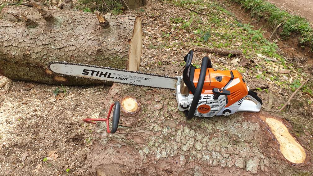

I actually thought that an 8pin for the 500i is an advantage because more displacement, power and torque on the paper, compared to the other saws. I can repeat the test with a 7pin, no problem. But i don't think it will change the outcome that much at the moment.
To the runtime, the 500i now has about 7 tanks through after my testing and some firewood cutting. The 572xp is the demonstration saw from my dealer and has 40h on the clock. The 462 is from an arborist, buddy of mine, easily up to 100h runtime. The 7910 from my dealer was a training saw for apprentices at the forestry school, over a year in use.
Sure, the 500i should gain a bit over time, still pretty new.
Here's a chart with stock numbers out of the german "KWF Prüfbogen Index" the 500i looks impressive on paper, the 572xp not really in comparison
Out of curiosity, what kind of wood is that you are testing in?
spruce ;)

I just made the point of reference to 8 or 7 pin because 7 pin is what the 7910 and 572 seem to have as standard supply in 3/8 set up (in the UK is my information) ... I see that the 462 shows the option of both on the IPL.
I know folks will/can swap the rim size around between 8 and 7 , but the 7 pin can make a difference to how the motor hangs onto its working rpm when cutting with a 25 inch bar.
25 inch is not classed as a "short" bar here and most often is going to be cutting hardwood where the sweet spot of rpm and torque is going to be felt easily.
I certainly would not be looking for you to do the test again Steph ! ...your test , your rules .
The outcome seems what you would hope...the 500i is no joke and the 572 and 462 seem to be on par with each other. Just as it should be if Stihl and Husqvarna are doing there jobs properly .

All saws should be faster with the 7pin with that bar/chain/wood combination (ok, maybe not the ported 390xp), especially the 70cc saw's (462, 572xp) should like it more, because of the powerband. But i have chosen the 8pin for the test to load the saw's more. With higher gearing you need more grunt down the rpm range, it's just that simple. I think i will do a re-test with the 7pin, purely out of interest.
I'm a little sad that I have not got a good running stock 7900 for the test, the 7910 is just clearly throttled by it's exhaust system and ignition.
