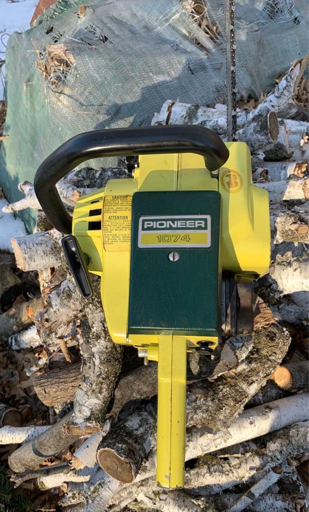

That green tint in the yellow paint seems to disappear over time. The pigment stabilizers are much better now.
There were differences in the export saws I'm sure. Ill' bet the black cover was factory.
Odd about the label being over the fastener. Maybe the wrong label was used at the factory or there was a warning label size requirement on export saws.
Anyway, yours is a fine example for sure.
The AF cover label on mine.
That may be true, only mine is much more greenish than she appears in the pictures.
I did some patches on her with enamel I mixed for my 1200A (shown some pages earlier)
where I did a full paint job. As sample for the enamel, I used a small patch on the inside of
the sprocket cover which definitely has seeen little if any light before and hadn't suffered
from dirt. So that self-mixed lacquer is very close to the original and when applied
to my 1074, you'll hardly will notice any difference.
There is a rectangular region on the AF-cover's upside where the surface lacks the leatherette texture
surrounded by a small raised edging. This area indeed holds a warning label:
I'm very happy with mine and like to give back the compliments to you. If I hadn't
mine I would envy you.

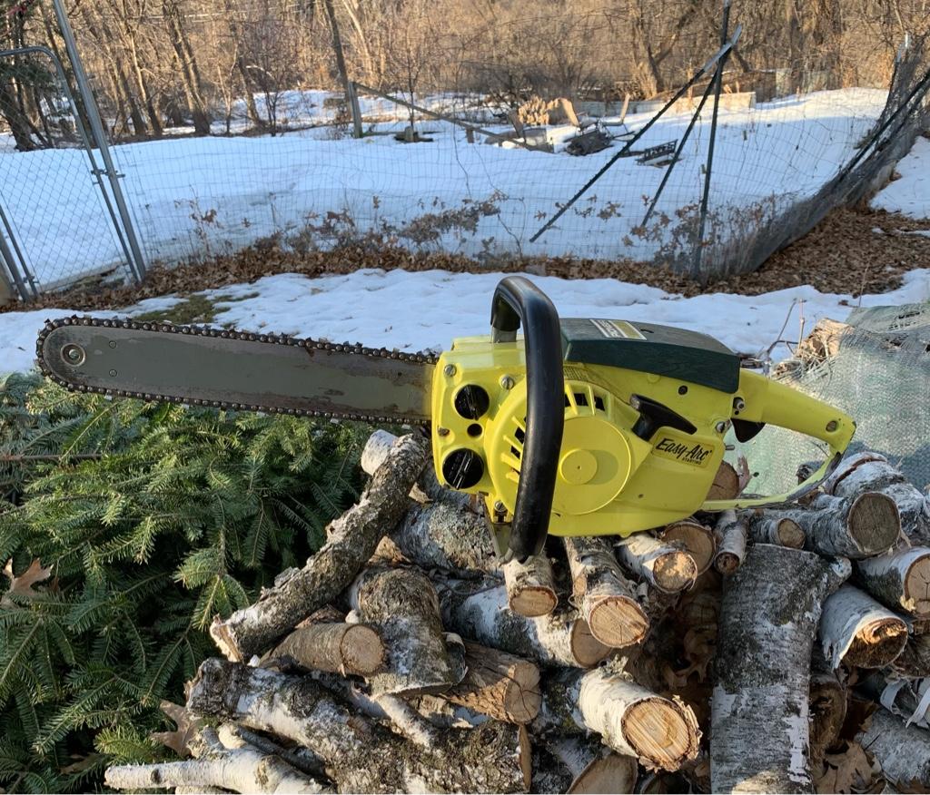

Finally got a different cylinder on this nice 1074 that I’ve had a few years. The plating was pretty well gone on the original jug and it sat on a shelf with not many hours on it. Something about these Pioneers, but you guys already know that! 1980 model.
Nice specimen.
