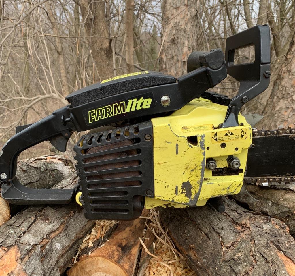

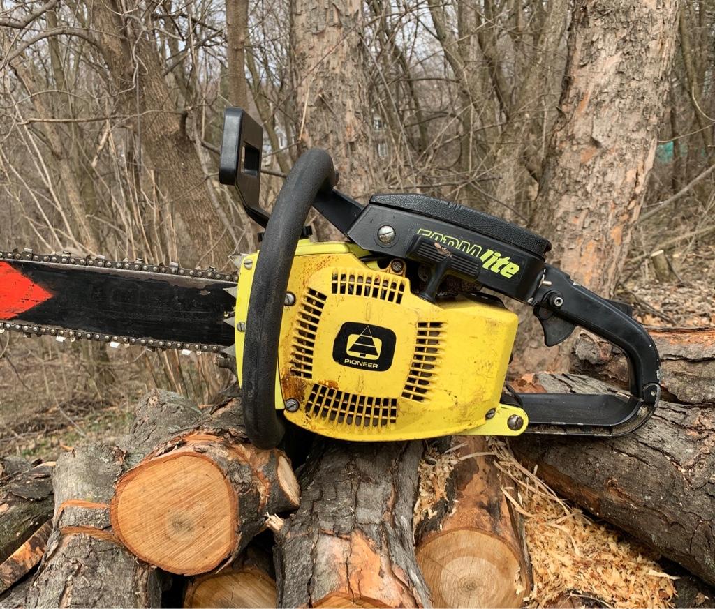

The third saw fires right up too. 3 / 3 !!
Two Farm saws and this Farmlite.
