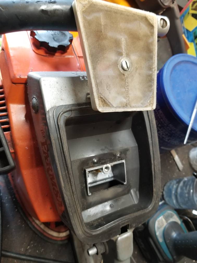

Well they are a little different. Wonder if its the one shown in pic.
If any one has a p39 could you please have a look for me and maybe post a pic.
Thanks.
Thanks.
The set up on your p39 is better than the farmsaw set up imo.

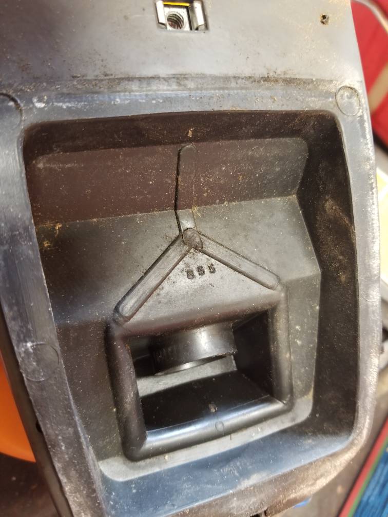

You know what the proper filter looks like for the p39? Is it like the one in my pic?
It very well could have came with that filter set up. It's far better than the mesh filter from what I've experienced.

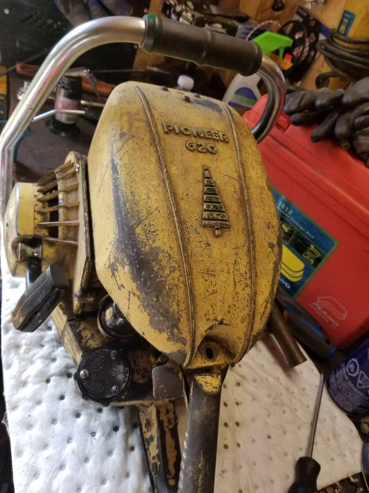

Got my 620 runing. Nothing more exciting then when you get an old saw running again. Always wonder how long they sat for. This one had fuel line goo plugging the inlet and rock hard diaphram and gaskets.
Need to make a gasket for where the filter housing thing bolts to carb and reasemble.

So these old saws like the 620 with the magnesium fuel tank ( or what ever it is made of). How do ya store them so they dont carode inside like this one was. Leave a little mix in them? Spray with some oil or somethimg? Its great to get them running but when ther not everyday saws they may sit quite a while befor they get fired up again.

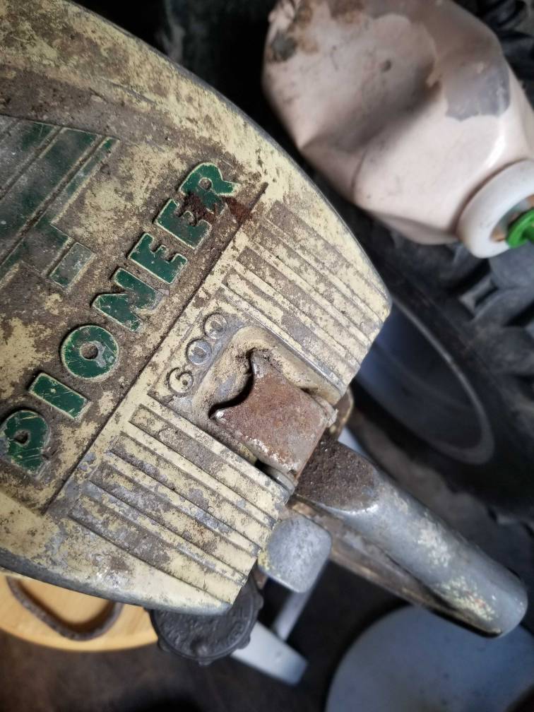

Trying to get this saw togeather and i cant find the bolt that holds top cover on by rear handle. Anyone know off hand what thread pitch it is so i can go get another.
Thanks

Oh crap. I wasnt thinkin too good this am. I got a 600 i will pop screw out and figure out the pitch.

Sun of a gun. I do need the thread pitch. The 600 has a latch set up. Not a screw.

The one from my 620 is 1/4 - 20 1 1/2 inches long.
