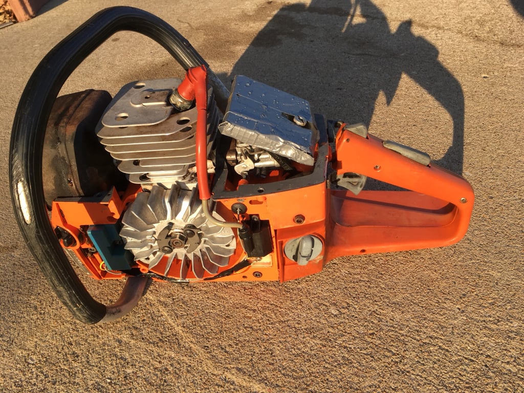

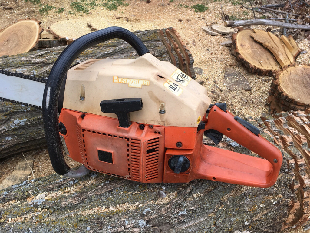

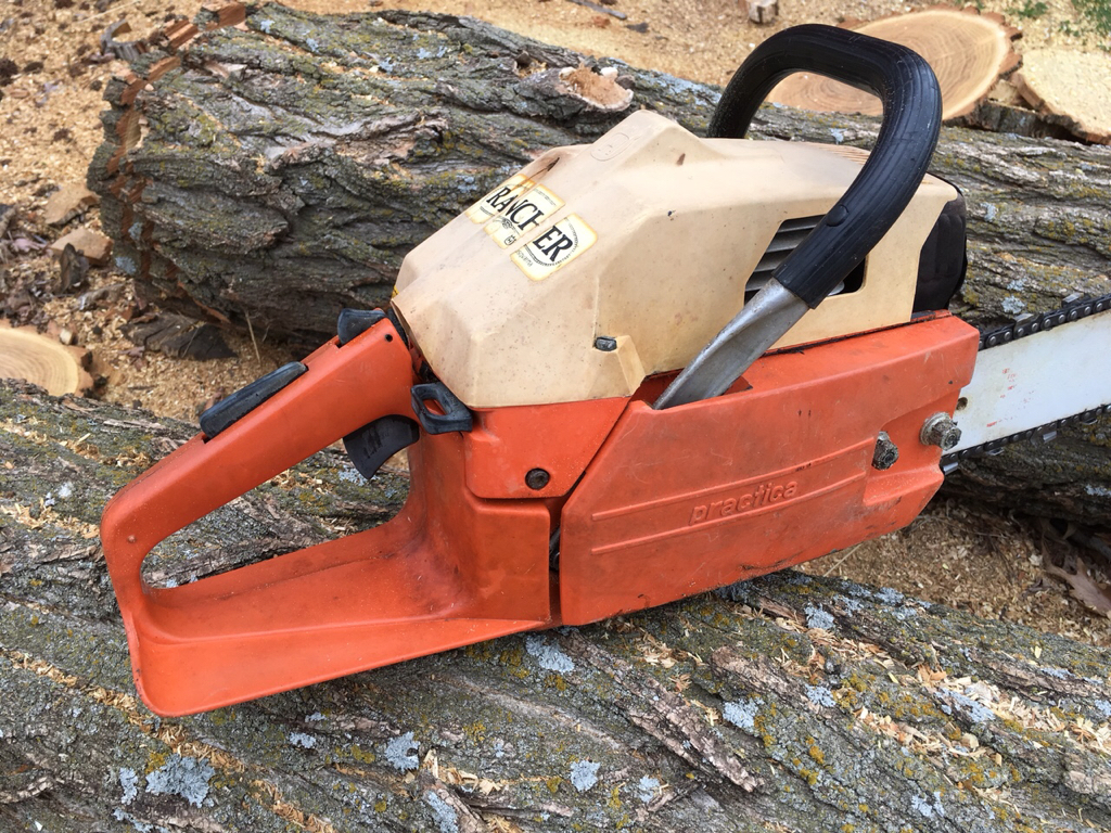

I converted another Practica last fall. I swapped the early equipped HS-163 with the later HS-254. Bumped up the venturi size from 15.9mm to 17.5mm. I swapped the throttle shutter from the 254 and shaft from the 163 onto the 254, so as to use the idle screw integral to the earlier case. I removed the original idle screw from the 254 and called it a day. I never ran it with the 163 to see if there is much performance difference. But, I am thinking bigger is better.
1st pic shows the final setup. 2nd pick shows the original HS-163 is in the middle. Full assembly with the HS-254 up top.
