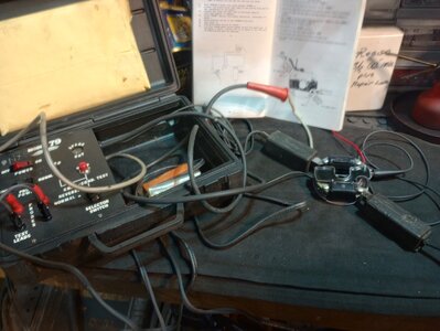

Are you going to try to foggy sail fix it?
I was just thinking I should order some of those capacitors as well, as I've a couple of Kawasaki type, one wire modules coming.
I can see the advantage of not having to advance the timing slots, which is the only variable for me not knowing just exactly how far to go, especially since it already has a bit of advance in the keyway already. I'm sure @mirage would like to just install it and be done.
First some research is necessary to determine if there are numbers I can put to testing the coil by itself. I'm going to guess that it is much the same as a points and condenser Bosch coil as there's no other way I can think of yet.

I might have some capacitors. Also if you use the chip you will have to advance it a lot I believe it is the same coil on the Bosch points and condenser ignition as these because you can swap the coils from either and they still work

Thanks, but, I just fired off on buying a couple of them. Also, have another theory in the works, if I find it's viable, I'll pass it on.
