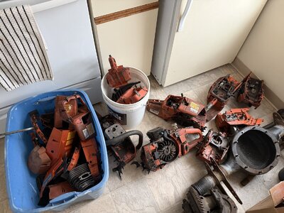

Picked up a parts lot off marketplace yesterday and am hoping to be able to at least make one saw out of it all. It’s looking like the only possible option is a 394/395 hybrid. Here’s a list of the cases that came with it all to build off of:
281
385
394 (4)
Got a bunch of carbs a cylinders in the bucket as well as other misc pieces. What would yall recommend

Have fun!!! I guess a thorough check to see what all you have there (including small parts, boots, cables...etc) and see what you come closest to. Might be worth it to bolt on a cylinder and do a leak down test to see if any seals are leaking...unless you are going to split the case of the one you choose and redo the bearings...etc. From what you show, you don't have anything in the 394/395 range, I would go for that to round out what you have.

Strip, fully disassemble and clean everything. Then inspect, looking for previously unseen damage. Throw out stuff that is not remotely repairable. Inventory what’s left and make a list using IPLs of what’s missing to build saws.
Don’t even bother trying to build something as is. Split cases, pull bearings, etc.

I would pair/match crank cases to usable cylinders . check the rod big brg, then seal the cyl to case so you can press/vac test not just the crank seals but the case gaskets and integrity of the case halves. Check the threads ...case and fuel tank.
Nice find.
Some members will build a saw up from ONE usable part so beware of cost overrun.

After digging through it all and cleaning some parts up, I’ve found that a lot of it is damaged. May not be as good of a find as I thought. I cleaned up the usable flywheel covers and clutch covers and half are beyond repair. Top plastics are also a bust besides 2 high tops and a couple 281s. Still have to fully sort it out. Going to dig into parts diagrams and go from there

If the plastics are just broken or cracked and not missing big sections, they can be repaired. Same with mag clutch covers…can be welded.
Post pics as you get things cleaned up.
Boneyard parts saws like this got thrown in the pile for a reason :p

Before you just chalk them up as a loss and toss them out, clean them up and take photos, its possible that what you have is in better shape than what someone has on their saw right now and will be willing to trade some $$ for it. Plastic welding and case welding are a thing and some people here have some really good experience getting broken stuff serviceable again.
