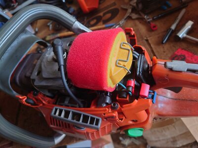

A little fun with the 359 today - Muffler mod and a dual stage foam wrap, around a winter filter
I'm looking to get into porting, and this seems like a good candidate with the transfer covers. Sounds like this saw develops a lot of power from a port job!
View attachment 471478View attachment 471479
Be good to have someone else in the neighborhood getting into porting.

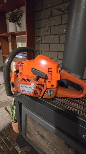

Hello All.
Rebuilding a 357xp now with intention to port.
With no base gasket squish is 20 tho.
Whats reccomenation on amont to machine on this model?
Was thinking to take 30 tho of both base and squish or is this excessive?
Cheers

Hello All.
Cheers
Personally I think 20 is the sweet spot for a small saw.

Hello All.
Cheers
I have a few I am working on myself and have seen a few recommendations. 0.030 looks like a safe amount to go with, check the timing after machining and see where you’re at.
Do you have some target numbers in mind?

No base gasket was:
106 ex
Transfers open 123
Intake 74
Thought to take 20/30 thou of both base and squish and finish exhaust at 104
Put transfers back to 17 BD
Widen intake a hair.
Good bad or ugly? 🙃
