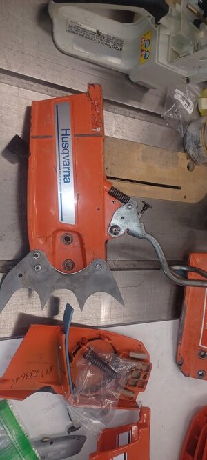

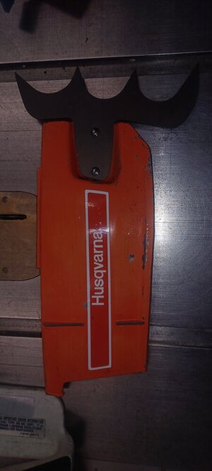

I’m working with a local laser cutting outfit to make the 3 types of dogs for the 2100 style long clutch covers. Inner that bolts to the case, outer that bolts to the 22 54 covers that are drilled for them and the odd one that bolts into the 27 49 cover like on the 268, 288, etc does. I’m hoping to have them in sets or individually.
Material choice at the moment is 12g stainless (cheapest) and Chromolly that I don’t have a quote for yet but would be more expensive. They can powder coat as well but I would need to either add that or not to full run.
Any suggestions as to material to use or PC or not?
Not looking for a new income source so they will be cost + freight, basically.
Thoughts, suggestions?
Outers
View attachment 470751View attachment 470752

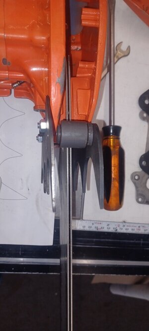

These will be drilled to accept modern chain catch rollers from Husqvarna and Stihl. The 27 49 dogs will be set to use Husky rollers like on 372, 395, etc.
the 22 54s will be drilled for Stihl type rollers.
Pics up later…View attachment 471654View attachment 471655
You should look into birchwood-Casey brand Perma Blue. It’s a chemical used for bluing guns. It might be better and more durable than powder coating.
singinwoodwackr
9:03 AM
34279
Sep 14, 2025
1,077
3,194
moon
I’ll probably just leave them as is. The Stainless pretty nice and it will keep costs down.

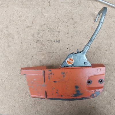

Not familiar with brakes on these. Is this what it say it is? And other than the busted handle, anything else it lacking?
