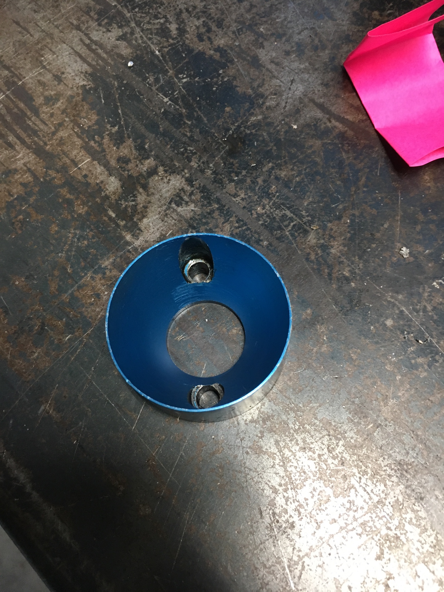

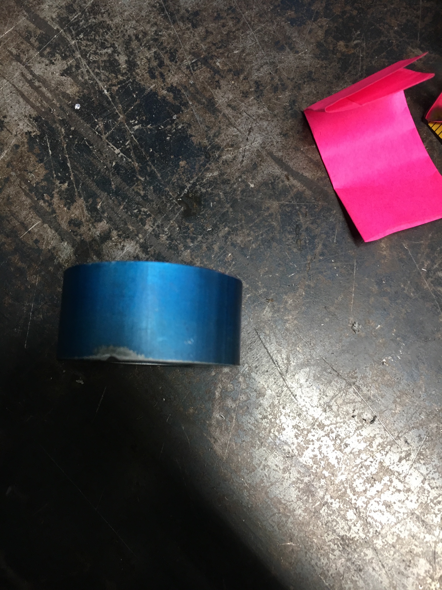

Does anyone have the measurements off of a velocity stack for a 2100? Also do any of you guys have a part number for a K&N or Uni filter for a v stack conversion?
Drptrch
Coastal Fartknocker
4:54 AM
690
Jan 27, 2016
1,517
5,615
Petaluma, California
1.75"
.75" on mine that was on saw with a weenie filter
flying pig
2:54 AM
1563
Jul 17, 2016
295
1,006
Grande Prairie, Alberta
IMG_1700.JPG IMG_1701.JPG IMG_1702.JPG I didn't quite go as small as yours. Found an uni filter on eBay that has a slight angle back, which should be good on the mill saw for keeping me from knocking the filter off with my hip. I set it up for a 2" filter. Doesn't look like it in the photo but I radiused the intake not too bad for no radius tool. I'm thinking that if the filter moves I may cut an oring groove in the outside and put a D ring in it so the mouth of the filter has something to 'lock' onto.
