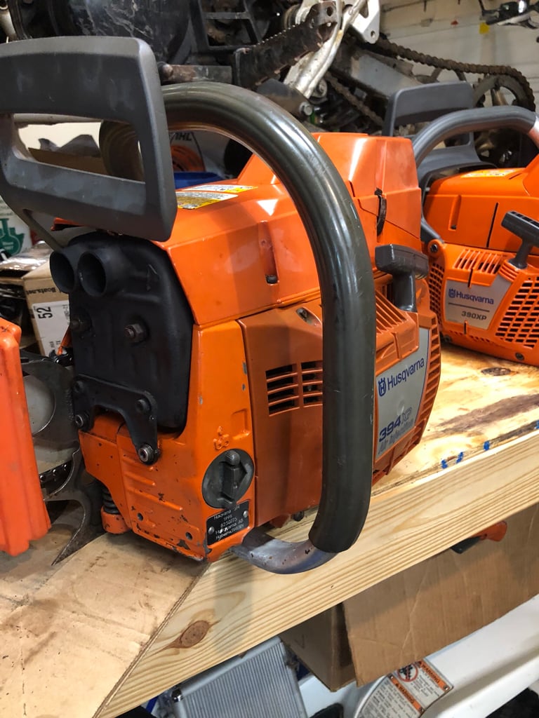

Fresh rings and hone, all stock.
The seal collar fell apart, new one on order.
Couldn’t help myself, put it back together for a test run. My first 394. Perhaps it needs to break in but it wasn’t what I expected it to be.

32 or 36? Square or round?
If you go back up a ways my saw is a little bit of port work but will pull a 42 with a 8 pin in oversized fir and a 60” with a 7 pin all chains are square ground falling chains.

32” round, freshly sharpened.

Yep, softwood and hardwood are different haha. Hard to tell dave but i feel like you could expect a little more from that too, but give it a couple tanks of fuel and see what happens. And put a 7 on it haha

I cut hardwoods too trust me with a 36 8 pin with square, I’m not a firewood guy I make a living falling timber the faster I can put down wood the more I make.

In my experience I’ve had saws that break in quick and others just don’t. It may take two or three gallons of fuel to really get it run in good.
I need another 394/395. They are just a great saw for long bars, and I’ve got several big trees coming down soon.

I’m not stuck to it, I can bring it to Tennessee if you need another.
