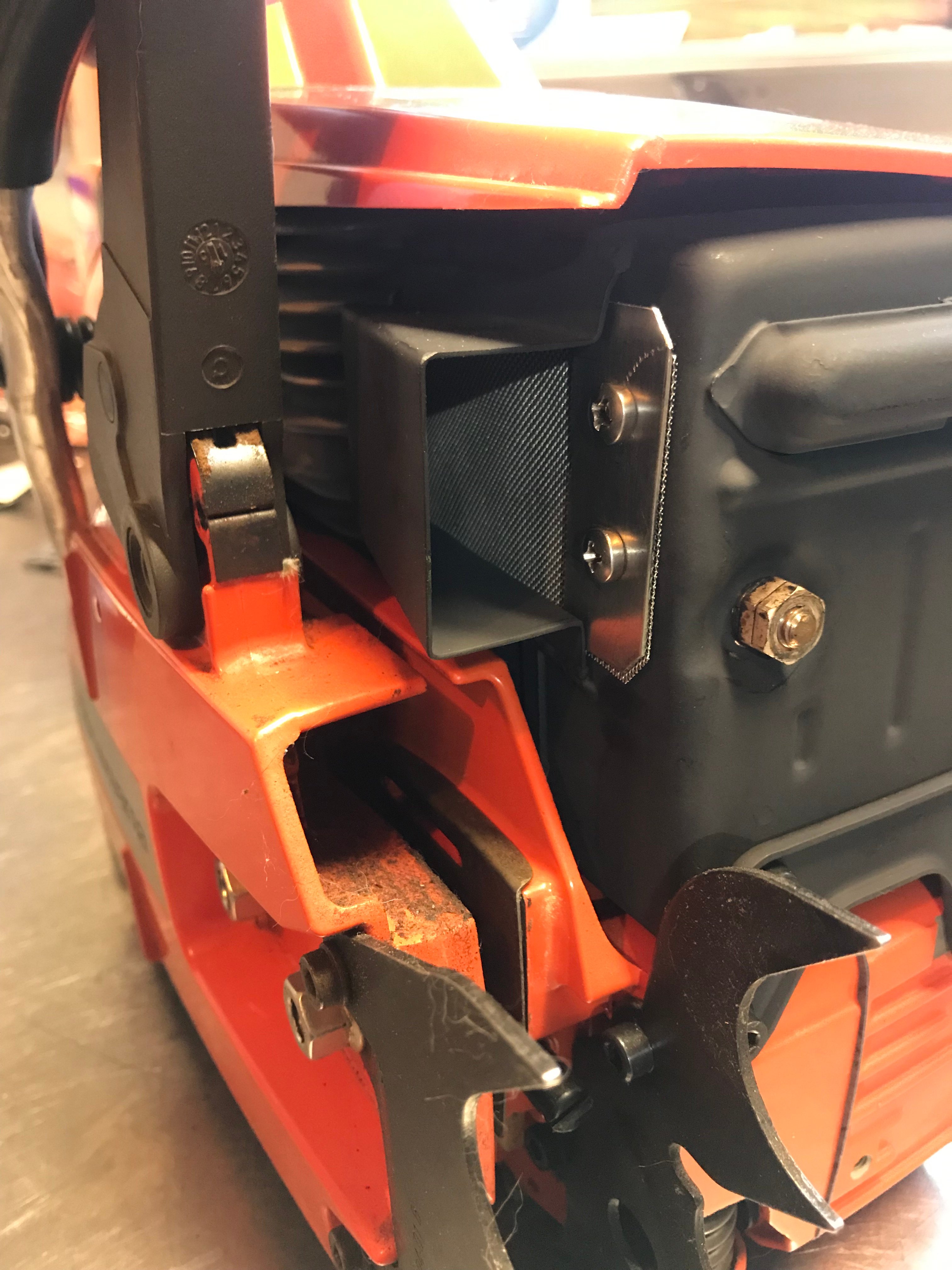

Cool. You guys stackem up...
srcarr52
11:09 PM
522
Jan 12, 2016
4,211
27,588
Iowa City
I like to gut it and make a big single outlet.
