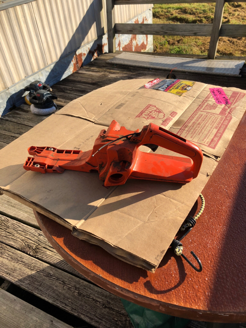

Speaking of another slight difference between 394/early 395’s and later 395’s... I discovered you can’t use the later tank vent on the earlier tank. At least on mine the tank hole was too large and leaked fuel a lot with the new style vent. Old style vent and problem was gone. New style is a restrictive epa vent anyway, prefer the old style. New style has a long hose that goes up to airbox, old style has a white breather plug.
