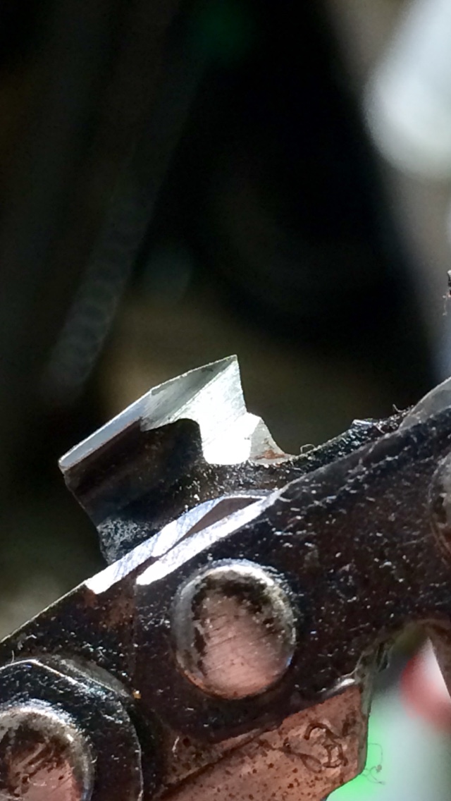

Ok guys here is my first time handfiling a square chain...I started with round chisel too...I have some Oregon square chain coming in mail so it should be easier when I have a profile to follow...comments, questions, concerns, and tips all welcome.... @mdavlee @Sierrawoodsman @Icepick69
Oregon

I got a couple at .019.
That side beak is something you can employ for softer wood and big power.
Other than that, I try to get as close to perfect intersecting lines through the working corner.
Oregon
View attachment 73816 View attachment 73819 View attachment 73823

Hardwood will take care of that little beak. In softwood some guys put a small beak on them.
