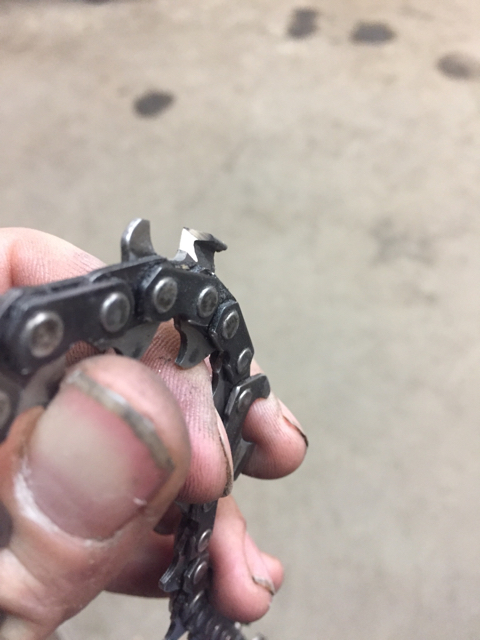

I even put a little beak on there for real life action..
Yep. I'll get all the good I can out of it.
I've tried air, brake cleaner, carb cleaner. without good enough results to bother with.
So I just grind em dirty. Then re- dress or spray the wheel off when it stops grinding and starts rubbin'..
