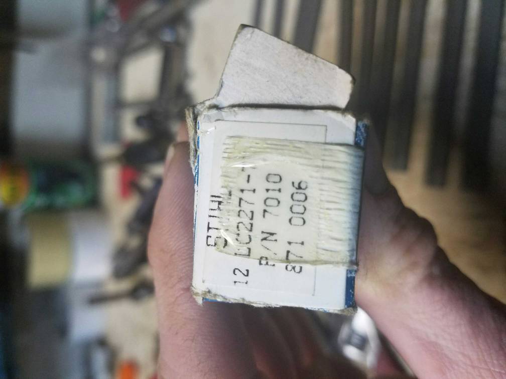

Does anyone know if Stihl still sells "square" files? If so, a part number? Thanks, Ron

Does Stihl make a flat file for the job? If so, what is the part number? Thanks, Ron
No they dont.. I found some at a dealer just out of luck. You can check the dealers around you to see if they by chance have them. Wish they would make them again, I really like them. I've used valorbe and save edge. I like the stihl files better.
Sent from my SM-G930V using Tapatalk
t4driller
Daddy Day Care
3:53 AM
927
Feb 23, 2016
1,470
5,590
Southwest pa
When they typed that number in the system it automatically goes to the triangle files. So you might have to go to dealers and have them look for old stock on there shelves. Good luvk[emoji4]
