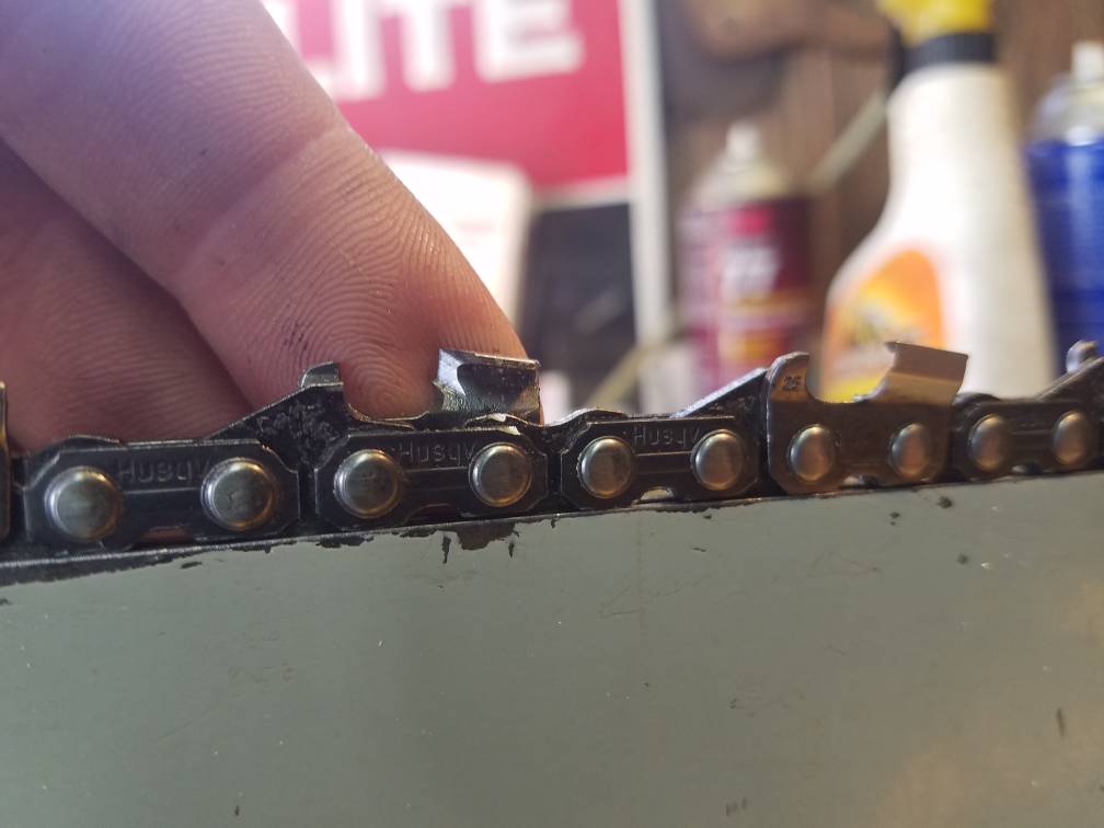

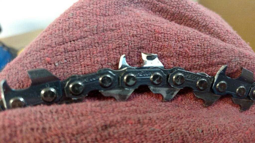

Round to square...
15 minutes or so..
They get a little warm..
Especially when the chains are this nasty.
It's all fun and games til someone gets their eye poked out.
Good lord that's sharp......and so repeatable
I even put a little beak on there for real life action..
Looks good...Is that with the salmon colored wheel that comes on grinder?
Yep. I'll get all the good I can out of it.
Can you slosh them around in a metal can with some kind of solvent?
I've tried air, brake cleaner, carb cleaner. without good enough results to bother with.
So I just grind em dirty. Then re- dress or spray the wheel off when it stops grinding and starts rubbin'..
You'd think those would take oil off. I bet it's burned wood residue. The brown stuff you notice about 10 minutes after your oiler hole gets plugged.
