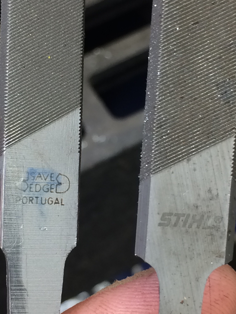

Converting RS..... how's your file holdin up?
I've done 6 84DL and 2 72DL chains.
I use the save edge to convert and the Stihl to resharpen. It's still doing good.
How long do most get on their files?

I could, converting really doesn't take that long with a file, maybe 6 good swipes. I think I'm just hard on files. I need to use less pressure.
Sometimes I push too hard after a few beverages
Sometimes I can't stop after having a few.

On a few good used chains I would take the gullet back on the bench grinder then start filing. Or should I just use a round file
