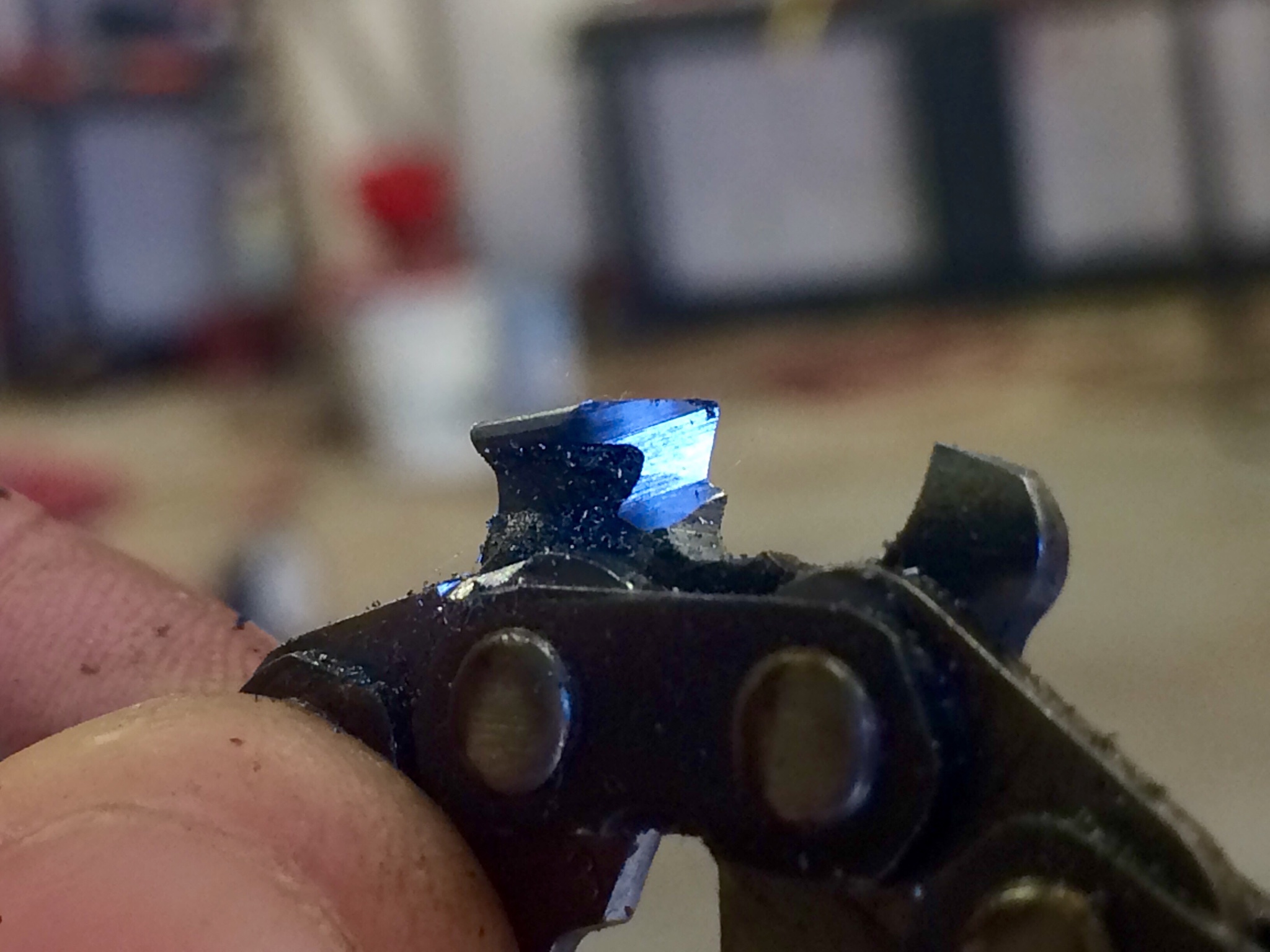

Took me about a half a chain to get my angles consistent. How's it look?

Actually, that tooth is gonna be very sharp and cut fast for a little while, but it won't last long, the line should be from the outside corner to the inside corner for a strong top plate, the top plate on that tooth is very thin.
Other than that it looks great.

Ok. I'll change up and see what I get and post later. This is a chain someone trashed the drives on.

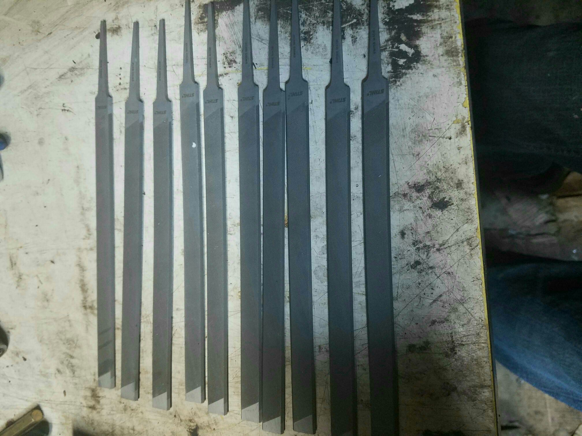

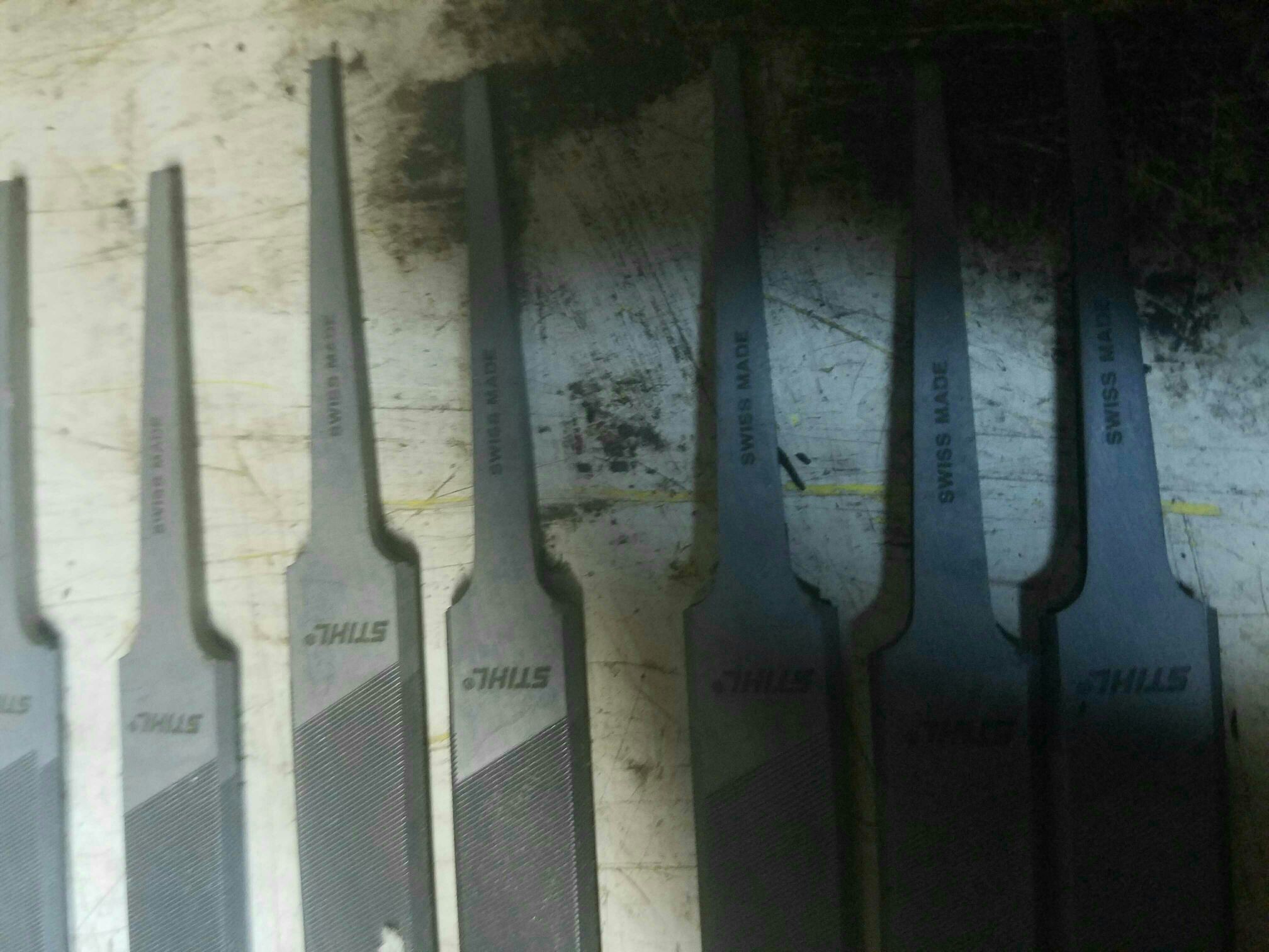

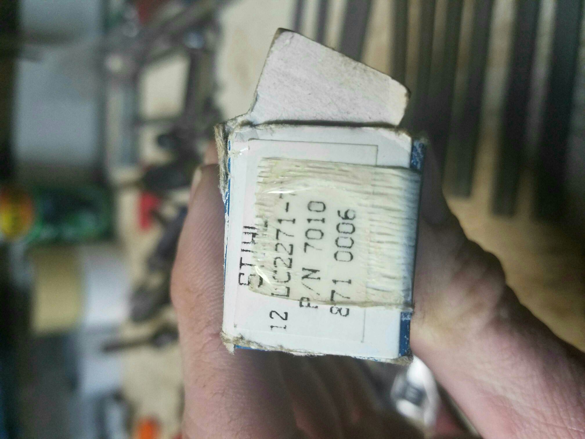

Got some time today to run down and pickup those stihl square files. Part number on the box is 7010 871 0006. He said when he typed it into the computer it automatically goes to the number for the triangle files they currently sell. He can not get anymore.
