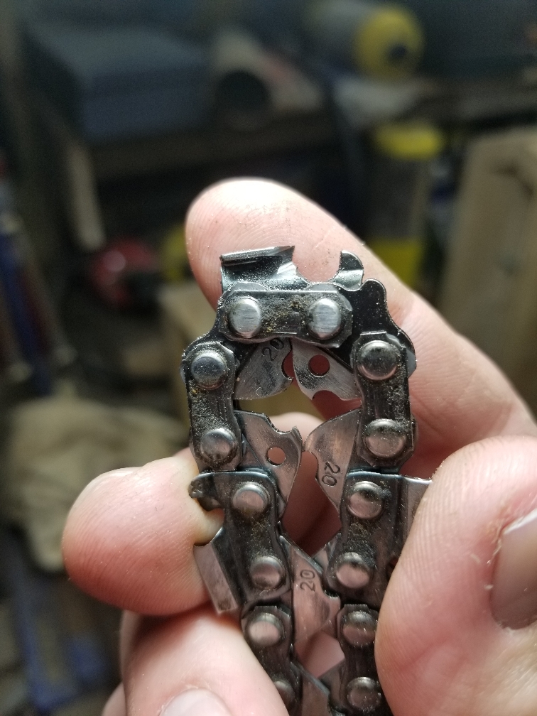

How's my corners look ????

I think the round file EXL was just a tick faster than the square. Nice.
To be fair, the square filed chain did hit a big knot in the log and ash knots are no jokes.
I broke my dragon slayer ax custom made oak handle trying to split one.
Also, the rakers have not been touched on that square filed chain and I haven't checked where they are at after the loop got converted from round ground to square filed.
But yeah, round filed performed quite well.

Generally speaking, square filed chains like the rakers a bit lower than round filed.
It should cut much better with a couple swipes off each raker.
