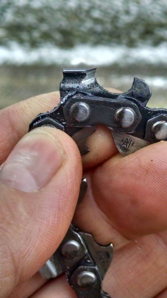

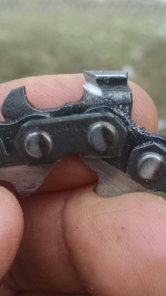

I hand filed 93 dl of EXL last night. Did the right and then the left, by the time I got done with my left side I was in the groove, and I had already learned a bunch so when I looked back at my right side I saw where I went off and improved them a bit.
This was the first one I did from round to square. Starting square is much easier with say 72 or something, you have a guide.

Once commonality I notice with a good hand file or grind is that you usually hit the tie on the back on the down stroke, not sure if anyone else sees that.

Yessir. Most of my straps to the rear of my cutters are hacked up.
