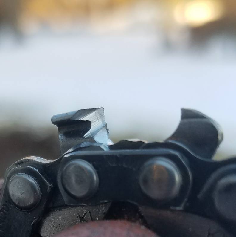

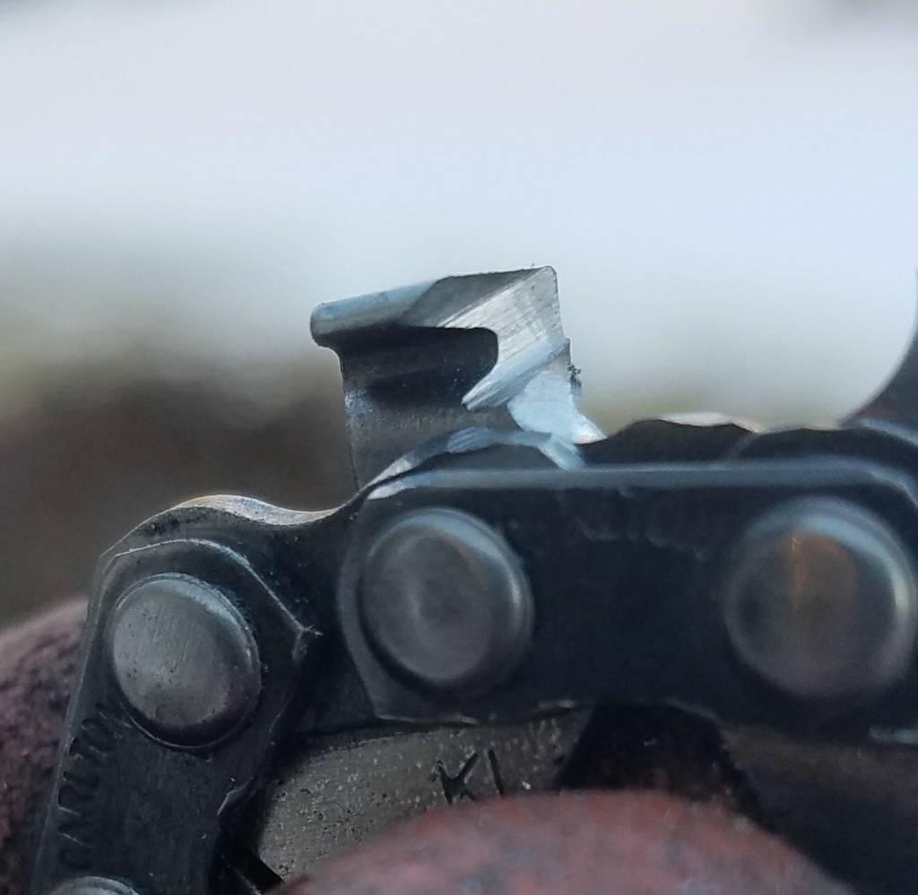

Well, here is my first attempt at hand square filing .325 chain. I picked a Carlton loop. Probably should have picked a Oregon loop. This Carlton is like diamond hard.
Not the greatest, but I really enjoy learning this square grind. Now I gotta get the chain into some wood to see how it cuts.

Looks like your top beakin'.

I hear you. It was a round filed chain that I converted.
The cutters are all chrome and extremely hard. I will put it in some wood and see. If it doesn't cut, I will get back at it. Looks better in person than from the pics. Lol

I can do that tomorrow.
Is it that the angle doesn't seem to line up with the inside corner?

From those pics, the corner seems a little high. Vs. low, which would be a side beak. Right smack in the apex is the sweet spot.
Ok. I will check that. I am wondering if my difficulty of trying to fit the file in the .325 chain is causing it.
