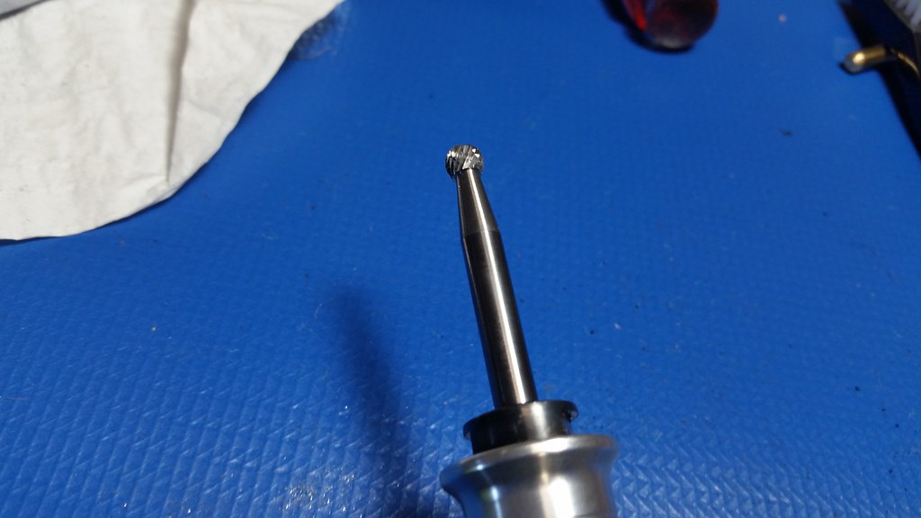

Thanks, Will do. I fabricate one-off's from aluminum and cres for my day job. I spend hours a day with a 1/4" burr motor, roloc's, scotchbrite, etc. so this will be a familiar task.

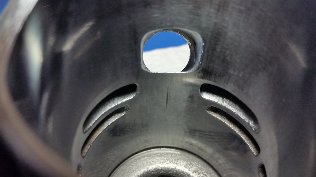

Got after it tonight, I think it went pretty well for my first time. Port edges look fine, except for one spot on the exhaust side that may have been a casting flaw or damaged when the ring came apart. I can see it well through the plug hole and the plating looks intact. It isn't raised or deformed inside the cylinder. Ok to run?
I started with 120, then 180 and 240 grit. Finished it with a good buffing with green scotchbrite on the roloc holder.
Thanks for everyone's help so far.

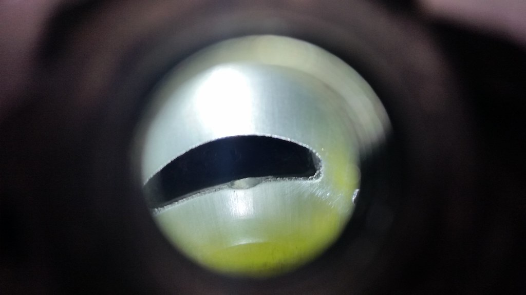

View of exhaust port through the plug hole.

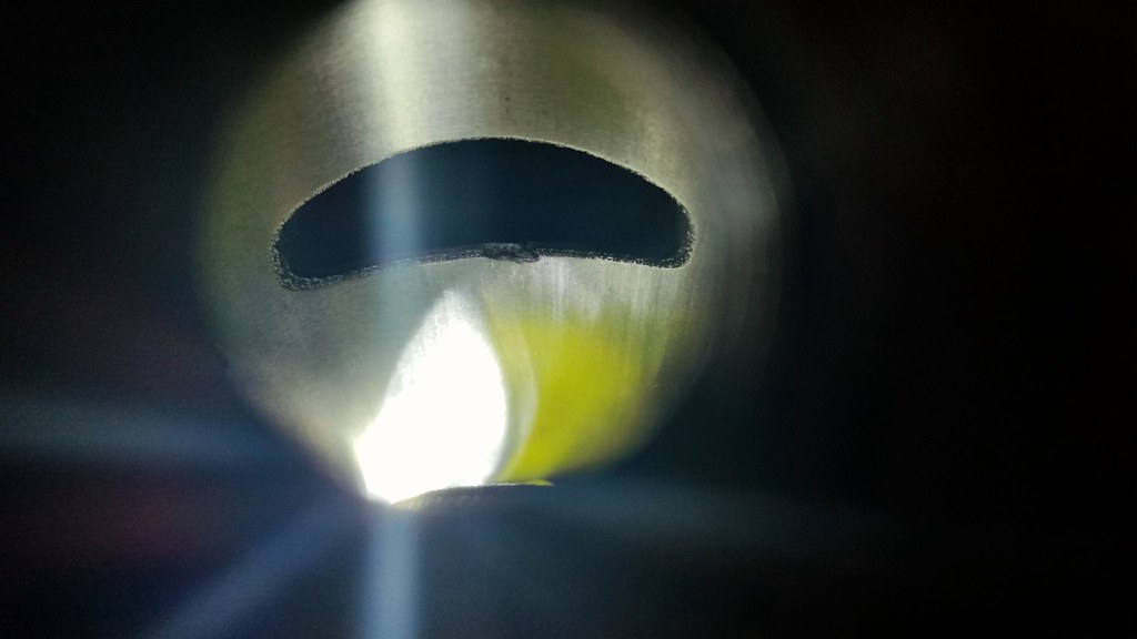

This what you're talking about?
Like this? or does it need more bevel?
