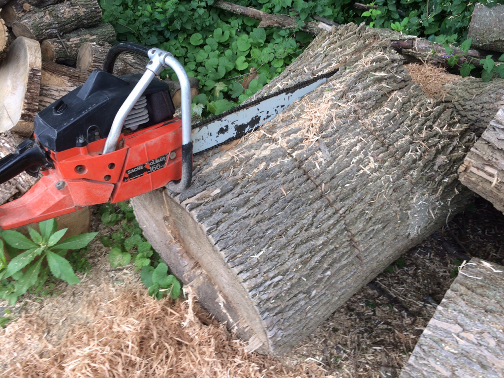

Gonna tell the wife that my new saw is a real efficient time saver. I can noodle 3 large Ash blocks at one time. She'll be impressed I'll bet.
You hope. LOL
