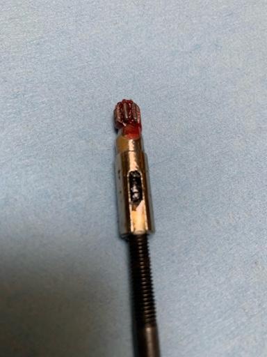

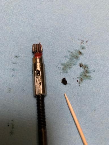

The problem with the MS191t oil output:
Was trash blocking the pump inlet.
It don’t take much.

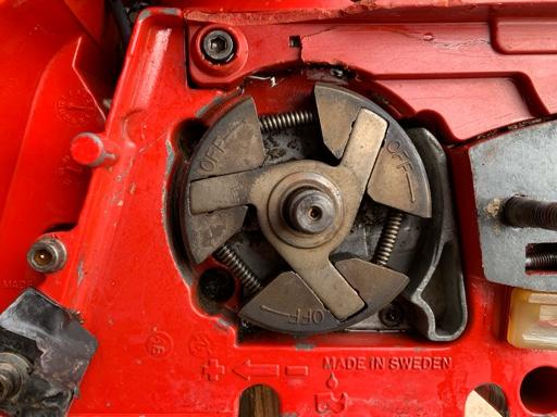

Gave the 2077 ‘The Dip’ and excavated [emoji90] to find the oil pump adjustment.
It’s behind the left end of that clutch shoe. [emoji3166]
Needs turned down a lot.
Brake band is AWOL.
Don’t turn it down!!
Let Er rip!!!
