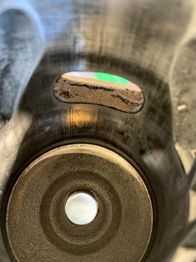

After twenty or so minutes of run & cut time the Alpina pumps 150. [emoji3526]
Not bad for what looked to be a junk cylinder.
We learned not to write off a shabby cylinder.

I've seen XL12's a lot worse and run excellent.
I remember Coby had, or still has, an XL101 I think. It's compression was so low it almost didn't have compression. He'd pull it up to the compression stroke and pop it through on that one stroke, maybe 6 inches of rope used, and that thing would start every time.
That was truly an amazing saw.

When you get down to it, the oldies Homelite, Remington, Poulan and Pioneer had vertical ring locator pins and the normal ring end gap was .070”.
They pumped 140 ish and ran just fine.
A lot more A/F escape area than those few scratch’s in the Alpina cylinder amount to.

A guy brought me a straight gassed blower , about 50 psi was it , I told him let's try to start it and run the thing hard as hell for a full tank without shutting it off ..
Liked to never got it started .
1 full tank later 135 to 150 psi .
He says runs as well as ever .
Lucky I guess

Yep it's in my shead, still ran last time

Ring finally scraped the transfer off the cylinder..
