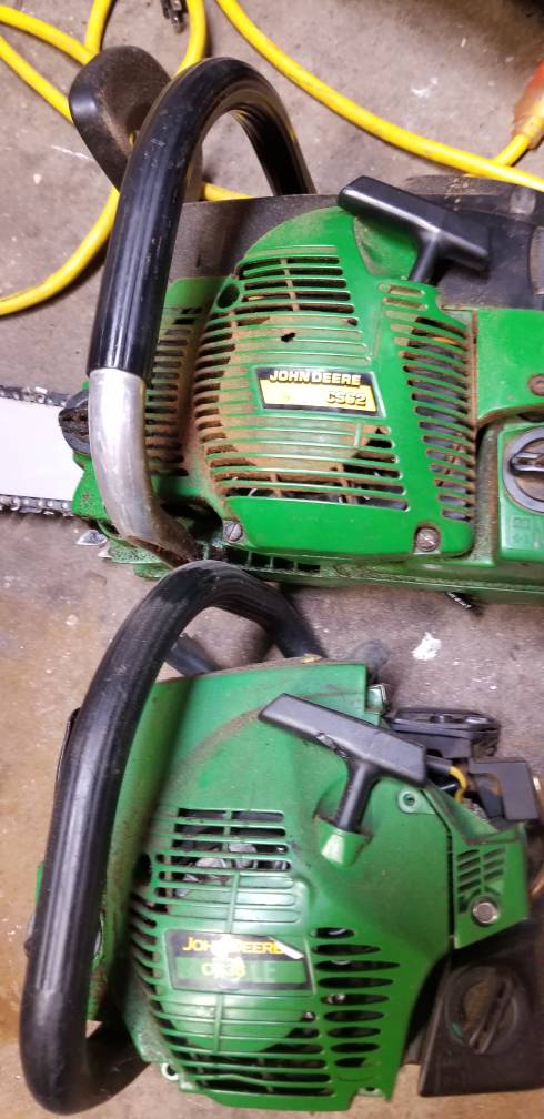

I think I’m still missing 2.
A cs62
And the smallest one. I think they made a 36 maybe.
But have never seen one.
You don't say? Maybe someday.
