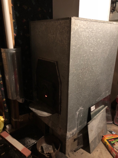

Finally lit a fire. This is such a big stove that I don’t really know how to use it when it’s only cool outside. Trying it with the air inlet only partially open for a slower burn. Fortunately the furnace works, but I have to slip the damper back in over my homemade plenum for the fan to move air properly. The stove alone makes quite a good whole house gravity furnace, with the basement stairwell serving as cold air return.
