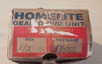

This one was dropped off this week. The fellow said it came from the Waterloo (IA) airport. Does not appear to have been used very hard.
I already had this one on hand.
So, now I have a Left and a Right in addition to one still in the case...I can't find a photo of it right now.
Mark
Mark
Showing my ignorance, are these two completely different saws, or are the cutting attachment parts reversible?
