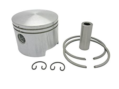

Is the SXL-925 piston available?
Yes through little red barn, 82cc model not the 77cc. Every once in a while you may find one on ebay.
The LBR piston will need clearanced usually between the wrist pin posts and on the skirt for the crank throws.

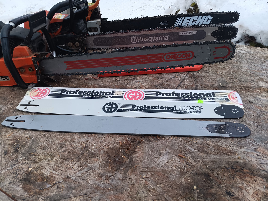

After a little over a year of looking all over, finally have a good supply of new old stock homelite bars for my CS 900 EVL. No thanks to those goofy light-weight bars on an old muscle saw. Love those old solid bars!
Oregon 32" 3/8 .050
Windsor 30" 3/8 .050
GB 30" 3/8 .050
Oregon 32" 3/8 .050
GB 30" 3/8 .050
😂But they're too heavy, you can't whine as much.few more years and people will be wanting plastic bars to go with their plastic saws and candy ass's
