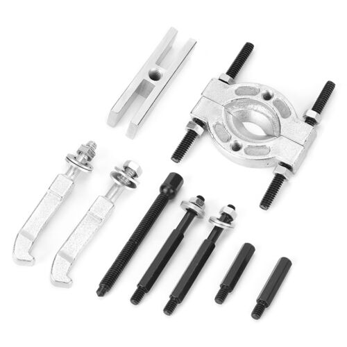

Can anyone suggest a bearing puller for the crane bearing on my 944. I got a full set of 2 leg puller but the jaws are too thick to get under one side of the bearing. Thinking about grinding the jaw thiner but that won't leave much material on the jaw

Can you get a bearing separator under there? Like this one:

I ordered that puller yesterday. I know you can just bust the bearing but don't way to take the chance of doing something to the crank. Thank you for the info

If you're able to get the bearing separator under the bearing, then you can use it in conjunction with a cheap steering wheel puller from the auto parts store and get the whole bearing off in one shot.
