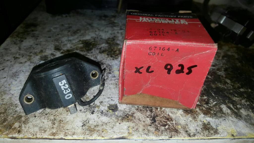

Well that's good cause my spare don't look like that.

I don't think the ones on my saws look like that either. Been awhile since I looked at them.

The 925's had two different ignitions. A one piece solid state module and an earlier three piece CD ignition. That coil definitely looks like the coil DSCF2970.JPG from the three piece ignition in one of my saws.
Another saw I have has a coil that looks like this
I'm wondering if the coil with the angled mount area was an attempt to get more cooling air to the cylinder area.

The picture showing 67164 is the coil on the first 925 saws. Part numbers 67162 in front of the coil and 67163 under the rotor, was the 3 piece ignition. A-02480 module replaced the 3 piece ignition in later XL-925.
chainsawlady
So this is the right coil and part number??
