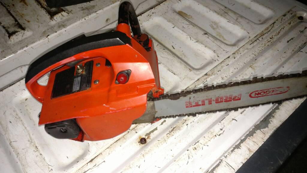

Just finished a little homie.

I've got a double trigger type about like that,no pipe though .These little things were Homelites answer for a mini Mac .About 100 bucks or less back in the day .
Most of them were sold as consumer saws.What few tree trimmers used them got a season ,maybe two .If they faltered they got shelved and they bought a new one .
If everything is working on them they aren't bad for a little itty bitty saw.

Naw milkman. Lol that's my answer to the impulse oiler that was filling the crankcase all the time. It's a manual oiler now.

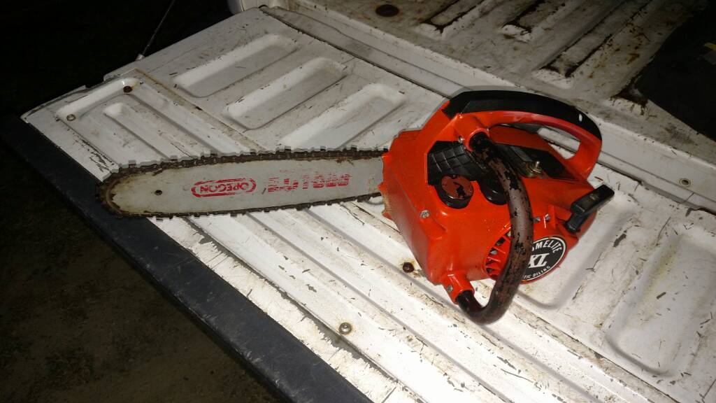

My 4 old homies. All running but the 72 super xl.
