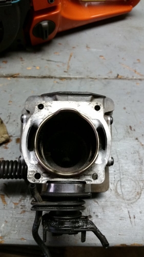

I was trying to find a pic.no luck yet.basically if ya pull the cylinder off.lay a cylinder gasket on the cylinder and then on the cases.you will see how the lower transfer opening is smaller on the cylinder then the cases.i laid the gasket on the cylinder and market it.then grind them to that.ill try to find a pic.

Like this

I see. Pretty easy fix. Thanks alot Brad. I think I might do that at some point. Got to see if it runs first, and how well. There had to be some reason that it was taken down...
If you do open the lowers be mindful of the transfer cap screw that’s toward the intake side. The pic above is of my cylinder, I took a lot more out of the intake side of those transfers after that pic.
