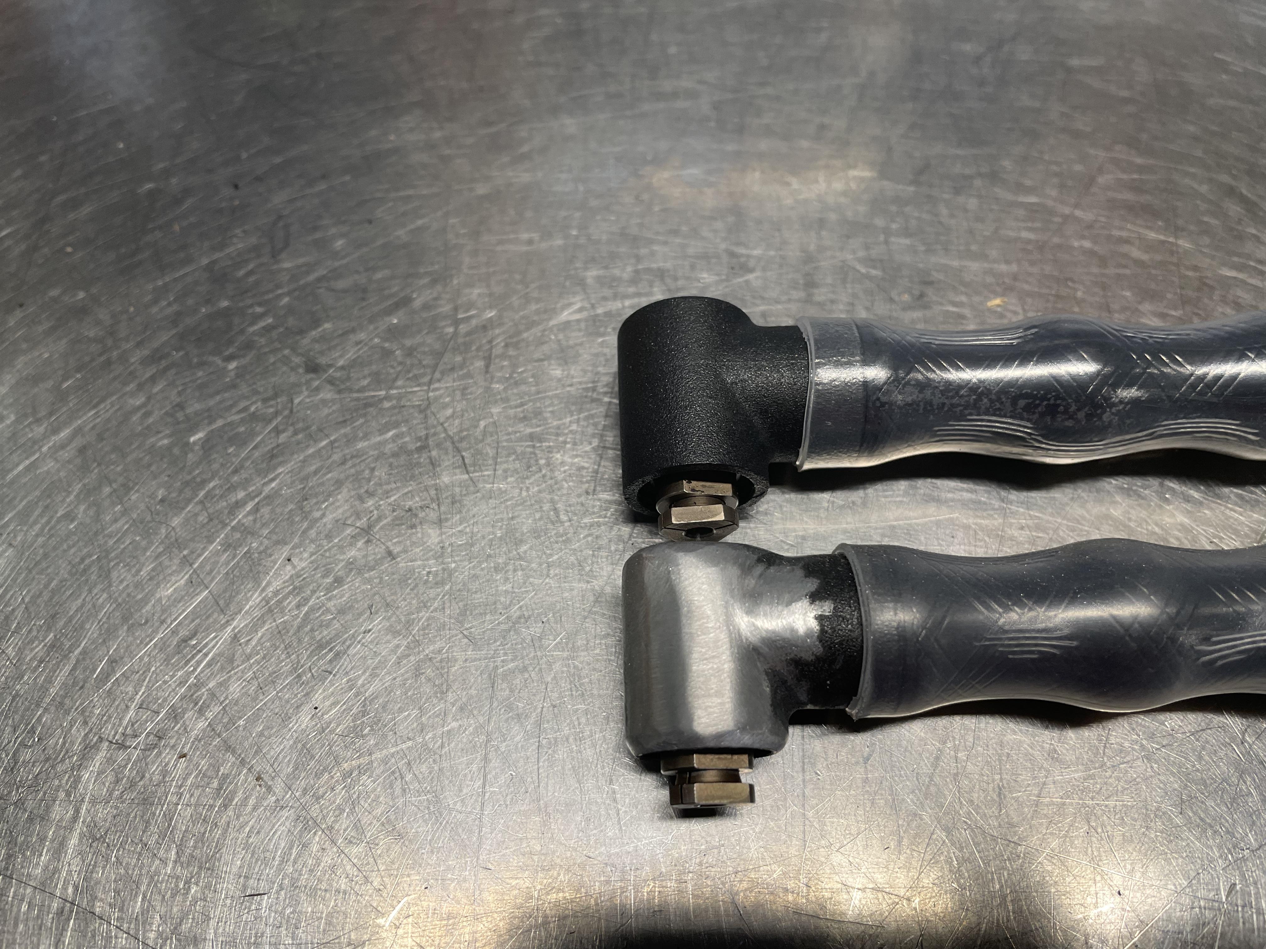

You can grind on the head and round the corners to gain a little clearance for smaller jugs if you want. It’s plenty thick to support the bearings.

Here is my personal one that I rounded the corners and buffed up the head of to make it a tiny bit smaller.
