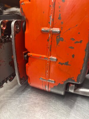

Well I might be needing some redkote after all… the hole is definitely not leaking, but the case halves are seeping. See the shiny gas in the picture. I assume that it would take care of things like this pretty well, correct?

Does that tank come apart? If so a new gasket and permatex aviation gasket seal will fix that right up without having to coat the inside of the tank.
I had a Stihl 075 fuel tank that someone attempted to use the pour in sealer. It didn't work so well the tank still leaked badly, when I pulled it apart all of that coating was pealing up on the inside. Had to scrape it all out, got a new gasket and used the aviation gasket seal and it is now solid. I have another older saw that has glued seams on its gas tank, I will probably fill the seams with JB Weld.

Permatex Aviation has been a go-to sealer for me for years. It’s been used on VW engine case halves since forever. These case halves have no gasket, just a smooth surface. Just so’s you know, alcohol is used to thin it or clean it up.

I have sealed 40+ tanks using Red Kote with only one mishap, in that case I did not allow the Red Kote to fully cure and the tank weeped a little staining the paint red.
The key to an effective result is getting the tank very clean to begin with, then allowing the Red Kote to fully cure. I think from a time/material/hassle perspective, cleaning the tank and sealing with Red Kote beats separating a tank to replace a gasket, particularly if the entire crankcase is involved. In the case of the McCulloch AV 10 Series saws, the tanks and screws are sealed with epoxy so getting the tank apart requires a significant effort including drilling and tapping the broken off hardened screws.
On saws like the Homelite SEZ models, sealing the tank with Red Kote is far more cost effective than splitting the crankcase to replace gaskets and reseal everything.
That's my perspective anyway.

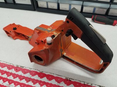

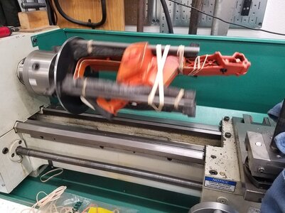

In fact, I cleaned a tank today by rotating is slowly in the lathe after filling it about 1/4 full of BB's, rinsed it out with acetone, and applied the Red Kote.
If you look at this photo you can see where someone had tried in the past to seal the seam by applying something on the outside. They were not successful.
I have it up on a shelf above the wood stove this evening to help speed the curing process.

$25 for 8 ounces of POR is not less expensive than $40 for a quart of Red Kote.
I have used POR15 in the past and will say that in my experience Red Kote is a superior product in all aspects.
Mark
Redkote it is then!

The BB's in the tank on a lathe is a slick trick.
