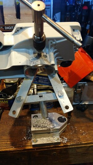

Jbweld is what I've used on a dozen mag tanks, the sealer is a little $$ but the can I bought is probably gonna last me my lifetime! Just cut it with acetone. View attachment 478840

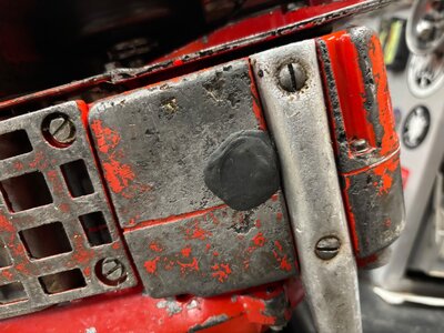

Well I acted quick yesterday and used the putty instead of the standard JB. I smooshed it in from the outside and tamped it down on the inside using the blunt end of a chain file through the gas cap hole. It is all dried and holding fuel now for the last few hours. Not sure if I should try to grind it flatter or just leave it be.
Just leave it be.
