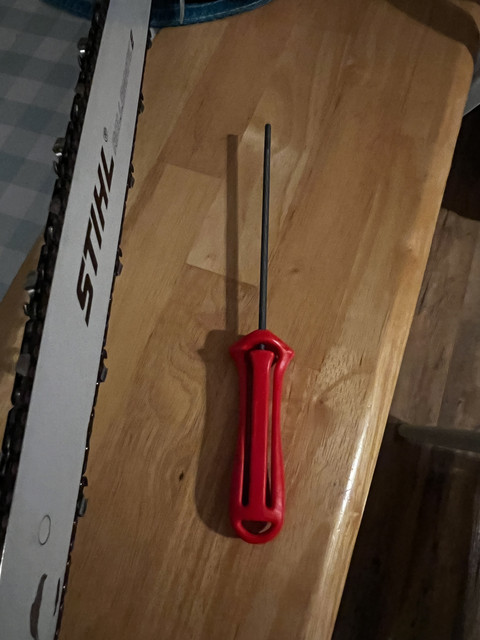

I have been using a 3/16 or 4.8mm Stihl branded round file. But I finally figured out the technique. I bought a Husqvarna file kit today. It came with a guide and all that jazz, but the guide is completely useless for my Stihl branded chains since it’s a sharpening kit for Husqvarna X-Cut chains lol. But man, these Husky files are INSANELY GOOD! They are Husqvarna 3/16 Intensive cut round files. And they work so much better than my Stihl files. I’m not sure why they work so well. But these files allowed me to learn the technique today, and I can actually sharpen a chain quickly and correctly. Hardly any pressure is needed and these files cut super fast! I am hitting the entire tooth. And it is all SHARP and flat! I use my nail, and check to see I can roll the chain back with the tooth point biting in to my nail only. And it’s super sharp. And no frustration at all.
I agree with this. Youtoob University can be very helpful with technical things like learning sharpening skills.
I finally got the technique down, I was jumping for joy about this honestly. Lots of frustration and pain has gone in to sharpening chains. Or trying to. I finally got it down with quick results. Husky Intensive cut 3/16 files are where it’s at. Going free hand only, I am following my angle on the tooth, and putting just a tiny bit of pressure back and upward keeping my file as straight as possible. These new files cut effortlessly with little to no pressure so it’s very easy to hold an angle and all of my teeth look perfectly flat on the edge. They are sharp. I filed the rakers down just a bit maybe 3 passes on each one with a flat file. Being able to make a pass on a tooth like 1-3 passes with good results, and then I move on to another tooth. Previously I was spending forever on just one tooth trying to get the correct grind across the whole tooth.

View attachment 432542View attachment 432543View attachment 432544View attachment 432545View attachment 432546
Few i know have found this regarding files, until something different is placed in there hands. This is good the fact you are trying different brands, not bias due to. Stihl files dont last nor cut as well, and i could never work out why they font address it but thats their call. May i throw this thought in the mix please, get a hold of some Vallorbes imo they are by far the best, then oregon, husky and whatever else must be used when these are not available. Credit to you wanting, trying, feeling, seeing, admitting the difference and moving with it regardless of brand, its like saws, ‘happy in the hand is a happy wood cutting man’ regardless of brand. Now your filing has changed for the better, enjoy that its a good feeling when a file cuts well, change it when it dont👌ps hand file only way to go for its easy to carry a single file👍💪
Honestly, I’m definitely willing to test out another brand saw. My Stihl 261 is awesome, and it ain’t going anywhere, but I will be buying a 2nd saw at some point in time lol. So yeah, maybe a Husqvarna 365 X-Torque lol. Not a huge fan of their newer styled saws. But I do love the classic solid orange Husky 365/372/395 etc. Those looks so 1980’s era. I like it!
Glad you got the filing figured out! Is that 3/8 or .325 chain?
Yep, running a 325 chain. I thought about going 3/8, but at this point I have 5 chains all in 325 lol. It’s working good on the 261 though.
