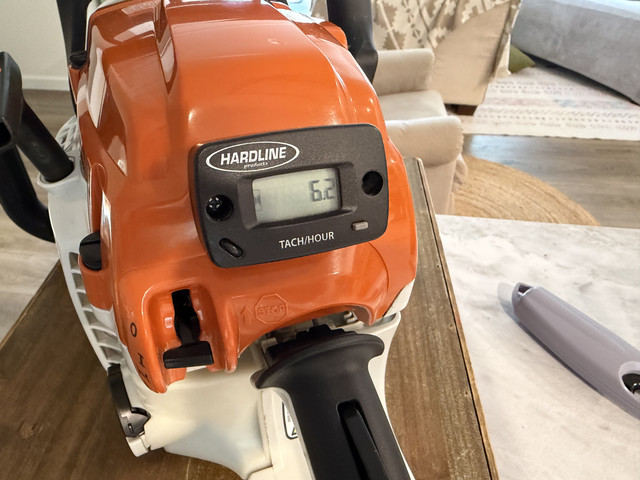

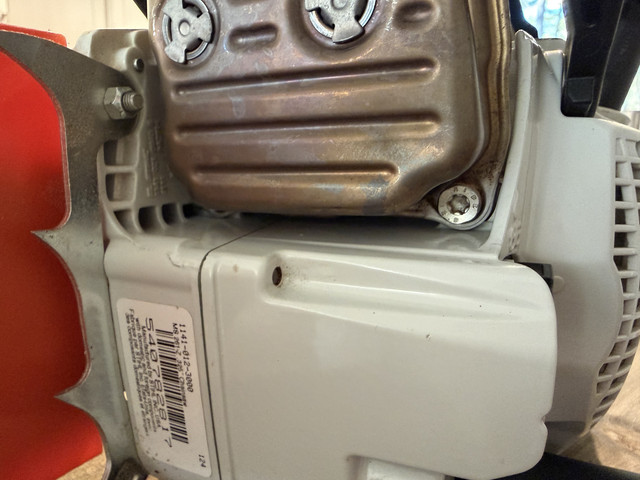

Okay here we are 1.5 years later! My Stihl 261 (Manual carb) saw has 6.2 hours run-time on the clock. I have been taking great care of it.

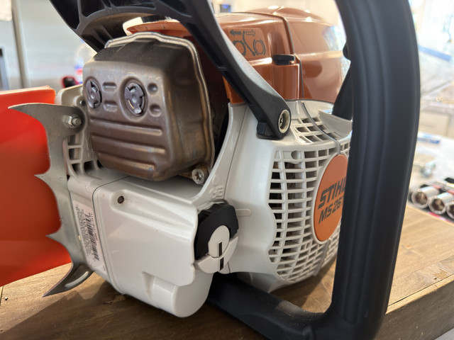

I run 32:1 HP2 oil, saw is stored inside my house in the laundry room. Kept it clean! I keep the filter and carb area spotless to avoid any dirt getting in the cylinder/piston area. I also sealed the stock muffler to the cylinder with some orange RTV (Exhaust manifold gasket maker) when I first got the saw, so no exhaust leaks under the muffler anymore. (I think most saws probably have an exhaust leak from the factory)

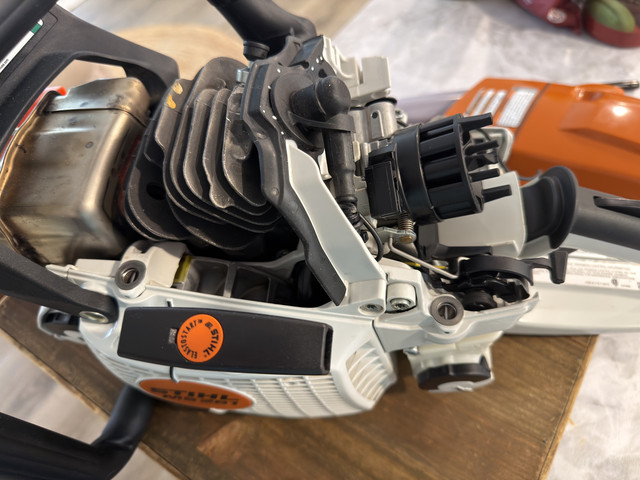

Wanted to ask a question to everyone. I know they say the default carb setting is usually 1 turn out from closed for high and low speed needles. I finally popped the limiters with a 2mm hex on my 261, and then I tuned my saw last night really well. After I got back inside, I checked and my high speed is 2 full turns out, and my low speed was 1.75 turns out. Does this seem odd? lol. 😂 saw runs better than ever. It cuts better for some reason, I think it’s because It changed the RPM in the cut, and feels like it’s cutting easier while revving lower, so it shifted the cutting where it’s more in the peak torque curve while in a cut. Max RPM is still showing 13,800-13,900 easily. Idling smooth at 2,750-2,850 range. Nearly Immediate throttle response.
I’m assuming it’s open so much because I’m using 32:1 mix, and it technically has less gas maybe?

When you rotate the screw driver 180 degrees the bottom of the handle is now the top or 1/2 turn. Doing this twice is 1 turn out but can seem like "2" turns. It is trick of the mind. Your more likely at 1 on the high and 7/8ths on the low. Is this what you mean?
Factory spec says without limiters 1 1/2 H 1 L as the starting point.

If you went this far, you’re ready for a muffler mod. I’m looking for a tree monkey video on tuning, will post a link if I find it.
I started off with a tach but only use sound now, once I hear the 4 stoke I know my H jet is good.

I’m not familiar with tuning that saw by rpm but that sounds too high, too lean to me. Does it 4 stroke?
