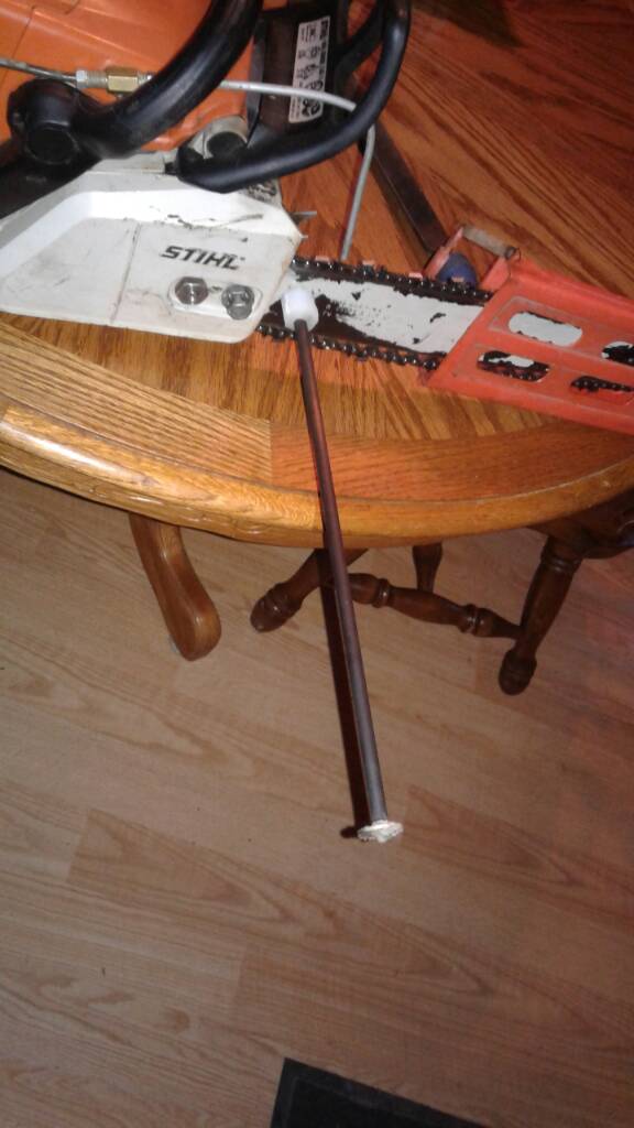

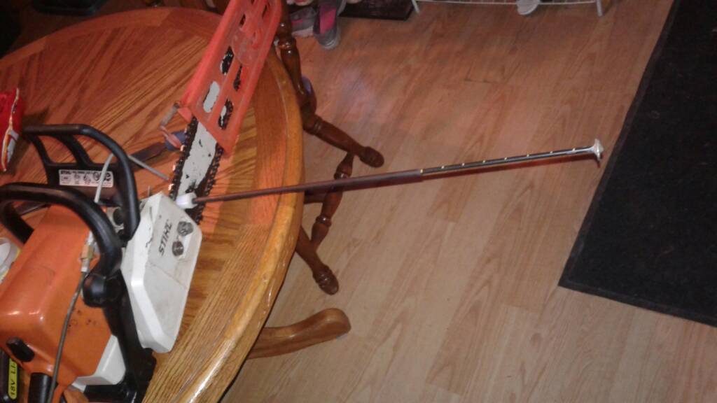

Heres my almost finished product. I made it adjustable from 14" (what i normally cut) up to 22". Ive been playing with it giving it the stress test and the epoxy is holding up so far. Im gonna probly paint it orange so it dont get lost.
Cant wait to try it on the saw and give it the real test.

Was out yesterday cutting and using the log measuring thing i made. I tried putting it a few inchs from end of the bar and that worked ausome. Never had to bend down to mark them, just walk down the tree and make marks and let the boy go to town bucking it up. Best tool in my opinion for marking the lenth.

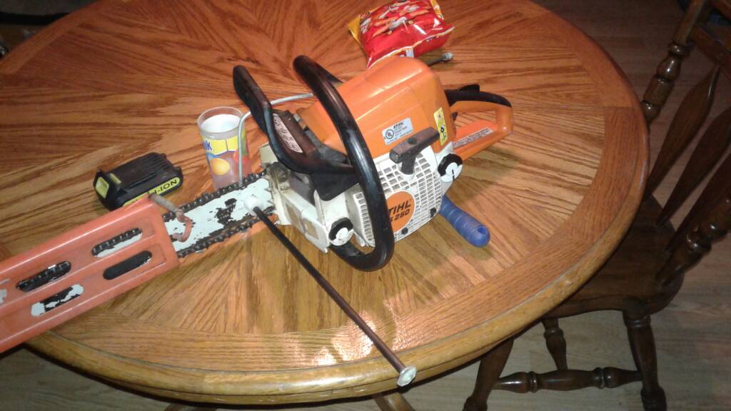

measrureing stick 026.jpg measrureing stick 026.jpg measrureing stick 027.jpg measrureing stick 030.jpg measrureing stick 030.jpg measrureing stick 032.jpg measrureing stick 026.jpg measrureing stick 026.jpg measrureing stick 027.jpg measrureing stick 030.jpg measrureing stick 032.jpg measrureing stick 026.jpg measrureing stick 026.jpg Picked up a magnet at Axman the other day, only rated for 15#, no hole moddle.
I sanded one side to roughen it and did the same to the head of a .38spcl. case and pasted the case in the middle of the magnet with JB weld, I then cut a 3/16" ring off of a 1/2" copper pipe and dropped it around the case, when filled with jb weld around the case it should be strong, (umm do not use a steel tool to apply jb weld around a magnet, it gets messy fast)
When this was dry I cut an arrow shaft to make 16" and pasted it in the case. I haven't used it yet.
